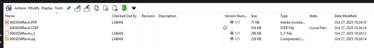

What I am struggling with is that the STEP file always ends up as a “local file” in the Vault rather than being ready to check in like the other three.

EDIT - never mind, problem solved. STEP wasn’t included in the PDM settings for file types to automatically add to vault.

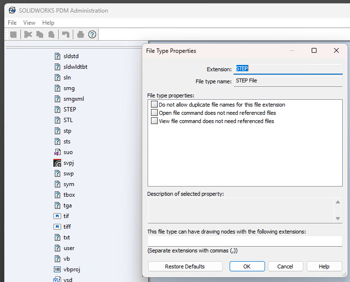

Have you setup the STEP file type in admin?
