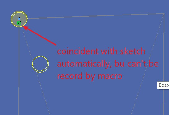

I’m try to build a model macro to do that, insert a center rectangle sketch, then inset hole by HoleWizard5, which hole center mate with the rectangle sketch, so I can change the rectangle size to update hole position. As if I draw the hole manually, In solidworks UI, it would set the coincident automatically, but when I record the macro, this mate would not be recorded.
Is there anyway to create hole and mate with sketch ?
