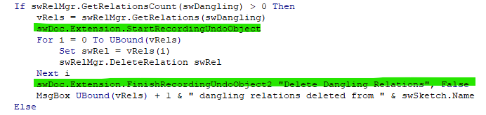

Not sure, but couldn’t this be fixed by using the following StartRecordingUndoObject Method (IModelDocExtension) - 2024 - SOLIDWORKS API Help?
Doesn’t seem to do anything. I haven’t used that before. Based on the help, I think I’ve added it per the proper syntax, but no entry shows up in the Undo stack, Undo doesn’t work, and exiting the sketch with “Discard changes” also doesn’t bring them back.
