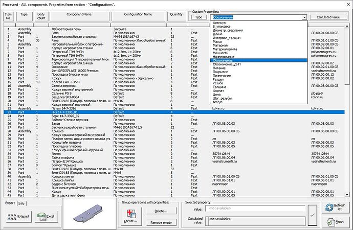

I wrote macro for group editing of user properties.
I was trying to find some free custom property editor that would display a grid and allow editing all the custom properties of each file in the assembly tree.
So far the best I could find is the free Solidworks Treehouse or the paid Properties+ from Xarial.
But Solidworks Treehouse keeps crashing for me and Properties+ is expensive, so I wrote this macro.
The macro is free, you can edit it as you like.
You can edit any Custom Properties from two sections: Settings and Configurations.
Main grid:
Source - PropertiesEn v0.8
PropertiesEN v0.8.zip (5.8 MB)

Editing BOM is a good solution.
But if you need to change the Performer or Verifier in several hundred parts and assemblies of the current project at once, or restore a Name like $PRP:“SW-File Name” to all models, then this macro will handle it quite well.
Digging around in the BOM will take quite a long time.
