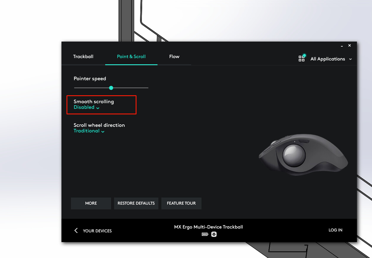

Using the Logitech App, Turn off “Smooth Scrolling.” That should solve it.
I love the MX Ergo, though the buttons to tend to wear down after a few years, especially the MMB.
I turned off smooth scrolling and it didn’t make any difference.
