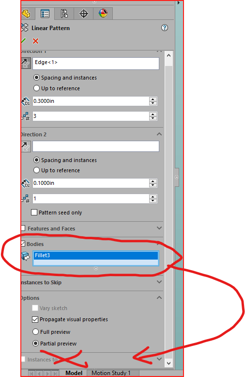

I have a job that generally takes a pattern in some parts. Until this job they have all been a standard pattern, but this is pattered at three different distances, so I want to use “instances to vary”. All the pattering is with cuts and some work nicely but some have the command greyed out so I can’t pick it. Does anyone know what I’m doing wrong?

You can’t use “instances to vary” with bodies. You can only use it if you are patterning features.
I can. Maybe that’s new with SW2024?
