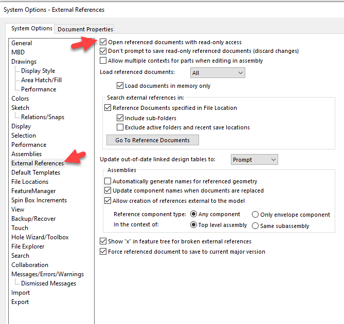

There is also the other option to always open referenced documents read-only which shouldn’t be used with PDM.
That SW option hints that it does lock the referenced files as they are loaded. maybe?
The PDM properties “Read-Only” is just the standard Windows read-only attribute to prevent writing over the file when not checked out.
The setting in SolidWorks is just something SolidWorks is doing and is useful if working with no PDM and you need to have multiple people working in the same structure at different levels. It prevents the first person opening the top assembly from locking access to all reference files, it opens them all read-only. We used it prior to PDM.
Best to use the read-only setting with the “Collaboration” option which just adds the ability to toggle the read-only/write access from the right click menu or file menu.
