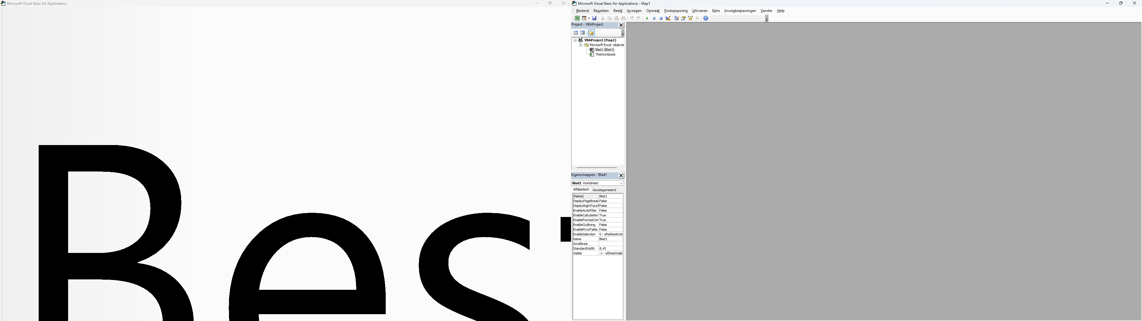

I’m encountering a strange issue that I haven’t been able to resolve. When I open the VBA IDE through SOLIDWORKS, the interface appears completely zoomed in the top-left corner. However, when I open the VBA from Excel, it displays correctly.
Please see the image below for reference, left: opened from SOLIDWORKS, right: from Excel.

As i can see from your screenshot the menus and tree are OK.

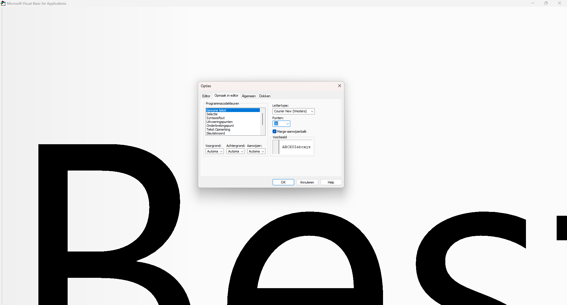

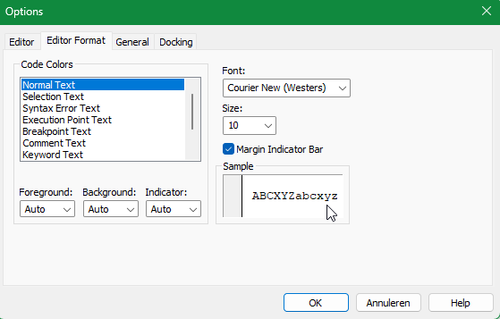

i’m curious to see what options you have in VBA editor:
Maybe tinkering here can help?

It was a struggle to get into the Options menu, but pressing the left arrow five times, then the down arrow three times, and hitting Enter did the trick. The settings appear to be the same, and changing them doesn’t seem to have any effect.
