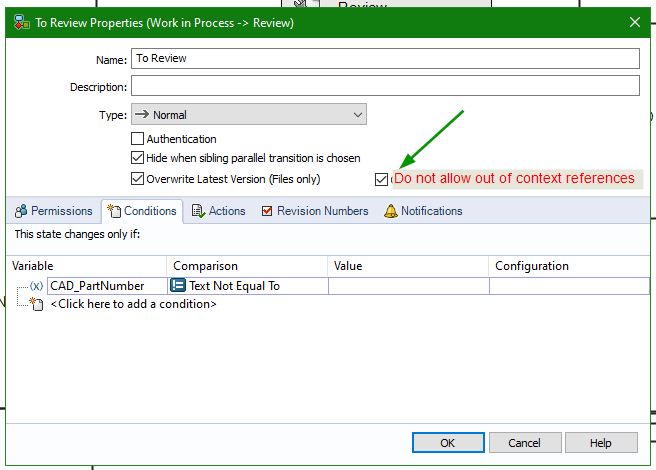

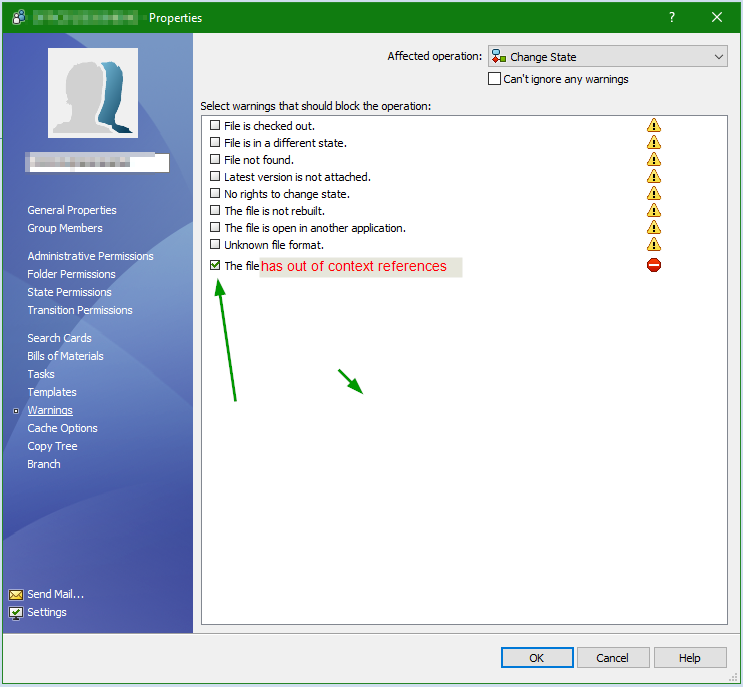

Maybe I asked the question poorly. We would like to prevent Out of Context External References from being approved in our vault. I’m not 100% against them during early development, but would really like them to be severed before the files are approved.

But this is what I would like to block from being transitioned to a Released state in PDM. In our dataset each part needs to be self-defining (exception being insert part such as mirrored parts). Sometimes users will leave these references in the models, and it makes a mess down the road.
