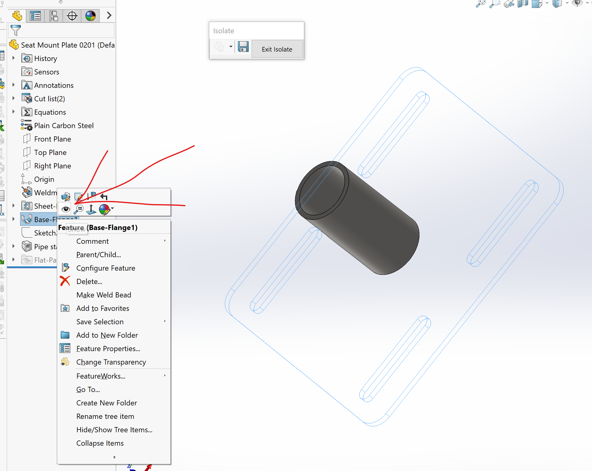

Simply make that component visible.
Right here. See snip.
In my case, invisible. To be fair, I think I worded my OP incorrectly.
OK, got it, visibility is the key. I never tried that, assuming that the part’s visibility would be permanently changed. I never thought that visibility in an ISOLATE was related only to that ISOLATE.

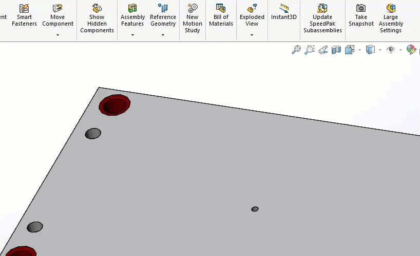

To add to this, on the assembly toolbar is a button called “Show Hidden components”. After entering “Isolate”, you can use it to flip over to the hidden parts, select them by left clicking them, then exit the show/hide mode.
Click me, I’m a video
The shortcut key for this is to hold down CTRL + SHIFT+ TAB, click on the parts you want to show and release CTRL SHIFT TAB
