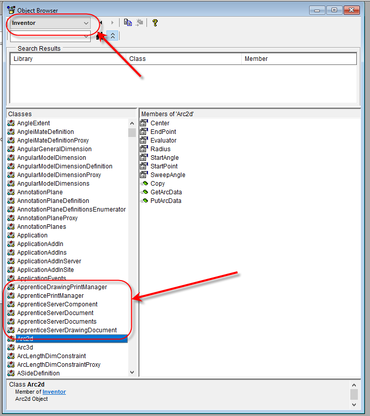

We already have both Inventor and Inventor View in our system. I was just trying to find the API library for it. As I was reading the using Apprentice Server article you sent, I came to the realization, based on their wording, the Apprentice API Library may actually a subset of the overall Inventor library. So I opened my object browser and sure enough. There it was.
Thanks for the help.

When attempting to reference the Inventor dll in visual studio, it didn’t show up in the COM library listings as I expected. I had to do a hard drive search for autodesk.inventor.interop.dll to find where it gets installed.
