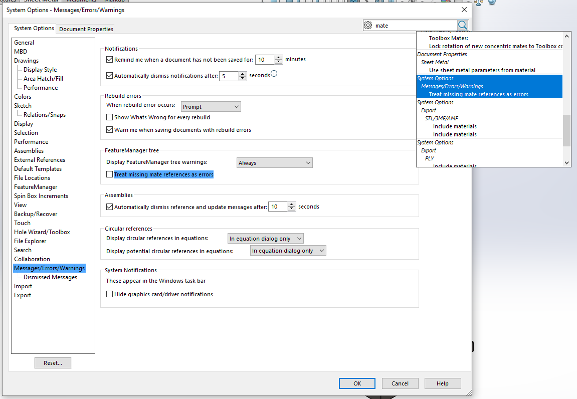

Don’t think this is a fix. I want to be notified in case mate references are missing.
Supressed parts with their mates should create no warnings, as has been the process before.

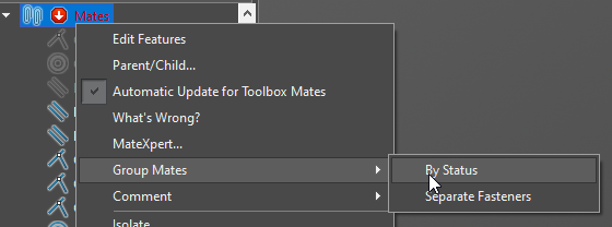

You could try grouping the mates by status. It isn’t super elegant, but it will tell you which ones are having errors and which ones are “Missing References”.
