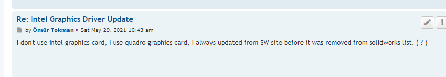

I don’t use intel graphics card, I use quadro graphics card, I always updated from SW site before it was removed from solidworks list. ( ? )
