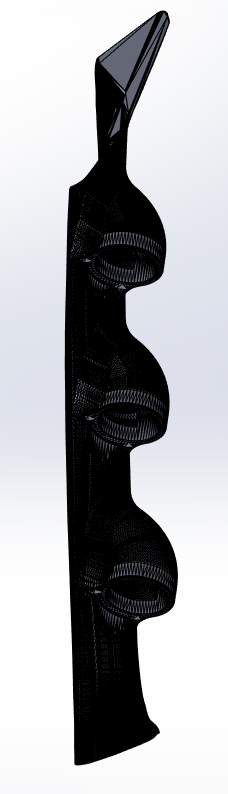

The 3rd image shows what is trying to be made.

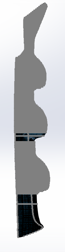

The 4th image shows the same angle as the third image, the lofts/slices, showing where these problems are occurring.

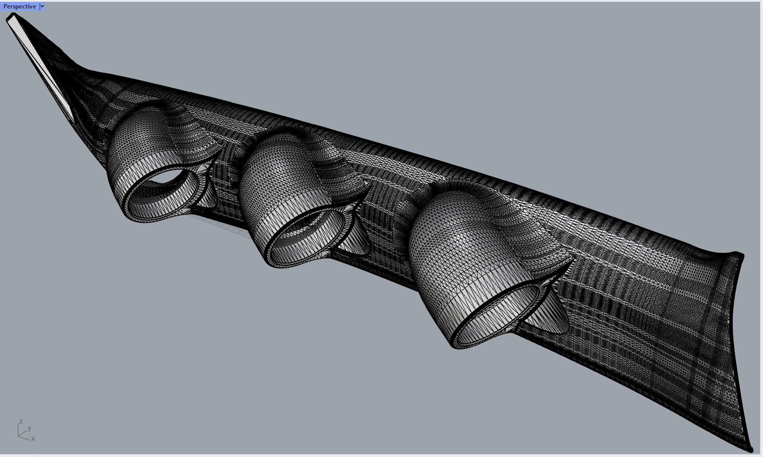

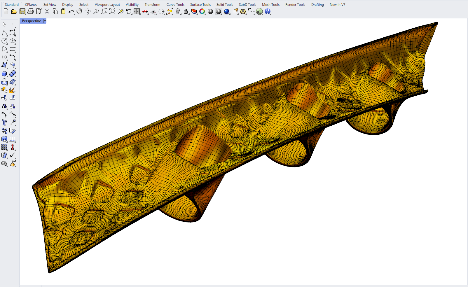

Using a SubD tool can help, this is using Rhino3D 7. The why you’re doing this is painful and not worth doing. Focus on the known geometries and boundaries to build your features.
Also, the obvious is this mesh gives many clues how the surface modeler created the geometry.
