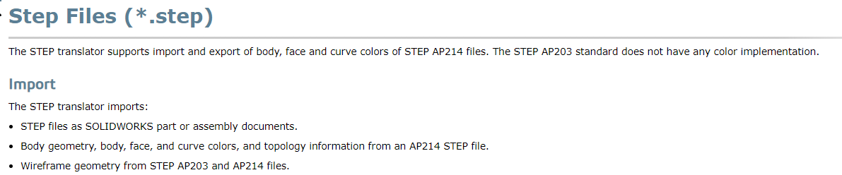

After digging deeper, I am confused.
The section on PMI says the step files need to be AP242.
But the section on importing step files doesn’t list ap242 as an option.

You are SOL trying to import AP242 in SolidWorks. It is not yet capable, not even in SWX2024.
https://help.solidworks.com/2024/english/solidworks/sldworks/hidd_options_import_general.htm
