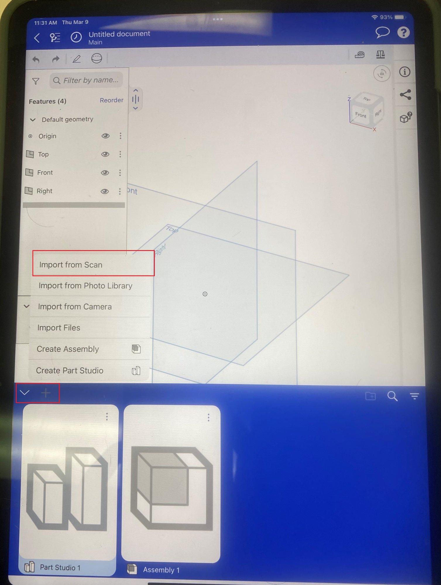

I am a new Onshape user and am just learning my way around. I found that IOS devices are supposed to be able to directly scan 3D objects. So,I’m trying to import from LIDAR on my iPad Pro but this option doesn’t show. Only import from Photos, Camera or Files. I don’t know how to fix it. Any advise would be appreciated. Thanks in advance.
Inside an Onshape document open the menu to insert a new part studio. At the top it has import scan. When you select import scan it takes you to the LIDAR scanning environment.
Here is a link showing it in the what’s new update from 5/16/22. Scroll down to IOS: LIDAR 3D scanning support with automatic mesh.
https://forum.onshape.com/discussion/comment/81307#Comment_81307
THANK YOU! It works!
