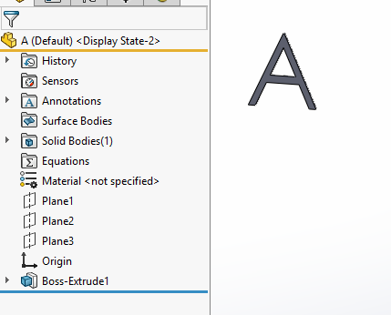

I have a need to rename files from outside SOLIDWORKS that are open inside SOLIDWORKS. The PDM API has a handy ForceReleaseLocks method that is supposed to detach a file from the file system so that it can be modified and such. I’ve found that this doesn’t seem to work for out-of-process code. To test this, I have a part file named ‘A.SLDPRT’ in my PDM vault and I open it in SOLIDWORKS:
The file is checked in, but is in a state and folder where I do have rename permissions.

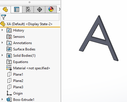

and it works without problems. The file is renamed to XA.SLDPRT and the feature tree reflects this change:

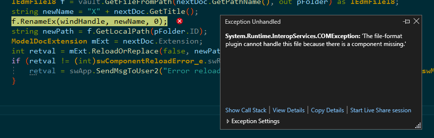

the program errors out with a rather cryptic PDM exception:
and strangely the file actually does get renamed in the vault, but SW doesn’t update. Also, if I wrap that RenameEx call in a try block and ignore the exception, I can inspect the Name property of the f variable and it still shows the old name, even though the file in the vault is renamed:

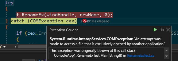

To add even more confusion, if I run the program when the only file open in SOLIDWORKS is an assembly that contains A.SLDPRT, the RenameEx call fails, but with a different error code:
This error sort of makes sense, but I thought that ForceReleaseLocks would prevent it. Ignoring the exception leads to ReloadOrReplace failing with a different error, stating that the document hasn’t changed.

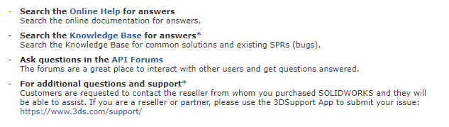

The API is part of SOLIDWORKS. If there is something in the API you think is broken, or isn’t documented properly and you are on subscription you are supposed to contact your VAR:
