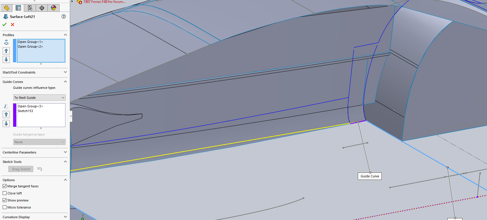

I can't select an edge. Selection filters isn't the issue.
See for yourself. When you edit Surface-Loft21, select the Open Group <3>. The line that is co-linear with the purple short line cannot be selected.
Interesting… it seem like surface trim 38 is causing the issue? I tried it on my end and seem like it only happen after trim-38.
Maybe a bad vertex/edge?

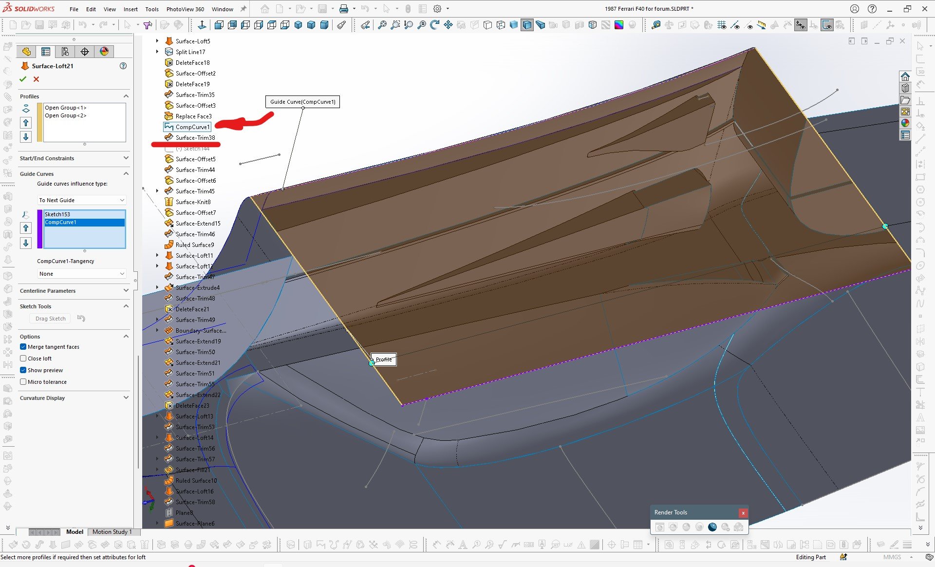

..here’s a workaround.. create a compcurve before Surface-Trim38
That’s a great workaround. Thanks, that worked! I didn’t even know you could create a comp curve from surface edges. I only think of it as a tool to join sketches.
