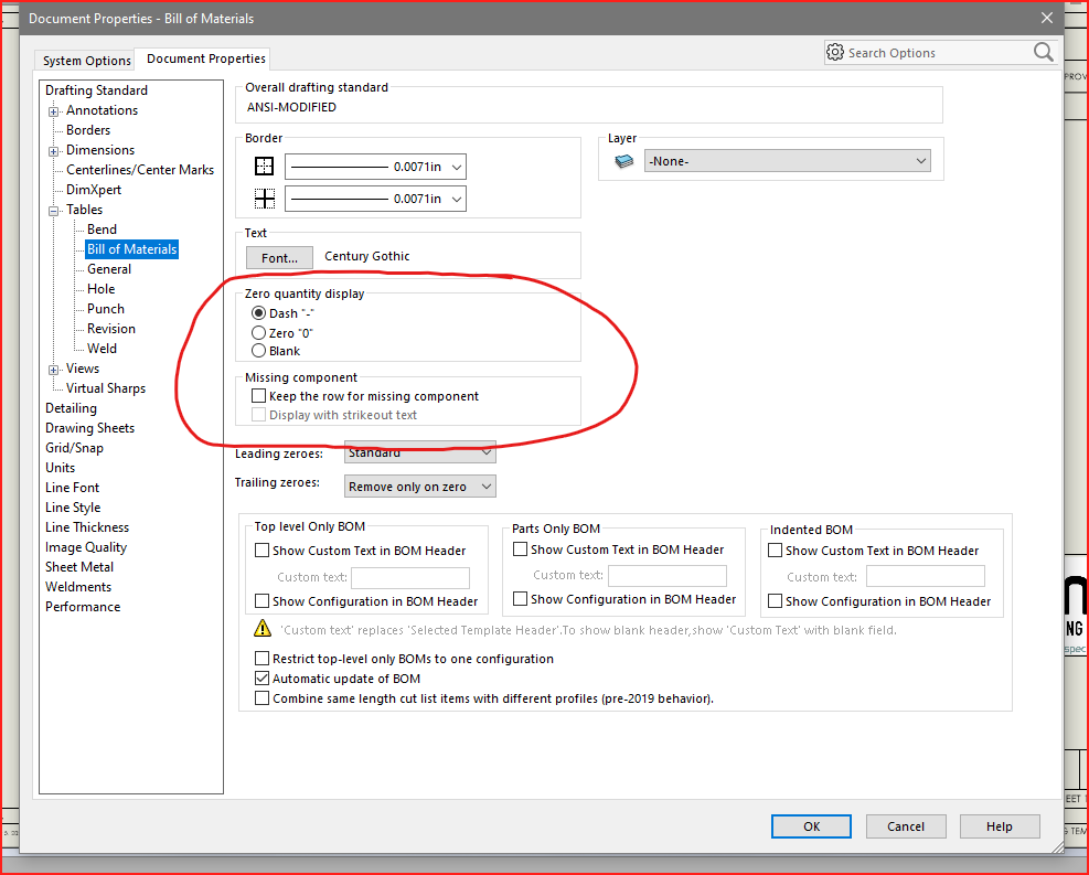

What does these settings do for you?
From SW 2022:
From SW 2018:
