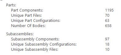

Keeping all of it updated and minimizing duplicates is a lot of work. As I said, we’re constantly looking for another “least bad” option.
The part count on our assemblies isn’t large so making every option a config isn’t a problem. If it’s on the ERP BOM it needs to be on the SW BOM. Loctite/solder/etc are in the SW assembly. Cables are done w/ ACAD so while there may be 4 different cables just need a correctly routed faked cable with 4 configs to drive the BOM p/n.

you didn’t steal the thread. I am following it closely but we just got presented with an impossible schedule for the next 10-12 weeks.
