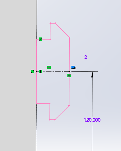

This “floppy” sketch array method keeps working better and better for me. I use it all the time for sketch arrays, and now I find that a “floppy” sketch circular pattern works great, too. This afternoon I used it to make a copy of some lines turned around 180 degrees. The trick is to not use the complicated relations created by the tool. Instead I filled out as few parameters as I could (just the count and the angle), hit the green check, then deleted all the construction lines that came in with the pattern. That left me with the copied lines at the angle I wanted, and I could drag them anywhere I wanted. I added some relations and got it locked down. Perfect!
The “floppy” sketch circular pattern is shown here. It fixed in place with the colinear relation and the 120 dimension.

Wow… this looks super clean. I need to try this…
Better in a second video but defiantly an interesting trick.
I have seen the advice several times to not use Sketch Patterns but you have show how they can be a very useful tool.
I have been frustrated before that I could not pattern features from the center. This is a good work around.
I would like to know how performance compares between a Sketch Pattern like this and a future pattern. For files with huge feature counts in the pattern this can be a real issue.
I’ve likely given that advice, although there are cases I’ve used it. Dwight’s example is good especially considering the way the hole wizard functions with sketch points and you can build it parametrically and control it. Outside of the Hole Wizard, I tend to prefer feature patterns since you can reference them from an assembly pattern. But it’s great to have another tool in the shed as you never know what kind of geometry you’ll come across.
