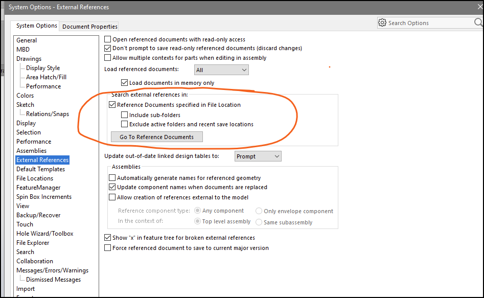

You should see a ? after inserted feature in the tree, indicating that the reference can’t be found. If you right click the feature and select Edit in Context it will open the Part1, rebuilding Part2 with Part1 open should update the geometry. The are also system options that control if and how referenced documents are opened automatically. These can be found in Options - System Options - External References
The OP did just that and saved Part2. The issue in question is Part2 reverting back later. I haven’t seen that, but I have experienced enough squirrely behavior when Master Modeling to always want the master open when working with the children. It was a while ago, but I had more trouble with body identities than with parts reverting. It helped to name bodies.

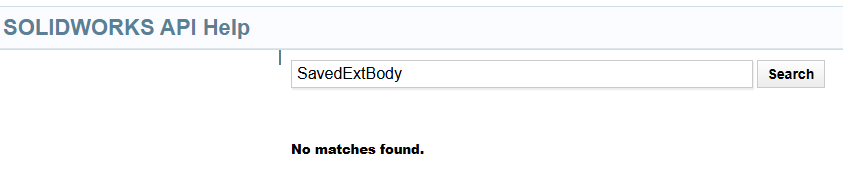

No, that’s not it. All the answers are clear and help to update the geometry by opening the Parent that the Child element refers to. I want to update the Child element itself so that the geometry cached in it is updated, since I just created it anew. And if I open it alone, it will still show the current version of the geometry. I don’t want to load the Parent, otherwise a carousel of rebuilds and saves and RAM consumption begins. It looks like I’ll go to the API branch to look for a description for the Feature: GetTypeName2 = “SavedExtBody”.
What I do in this situation is close the component that references the external component, on open, select ‘References’ and replace the reference with the one you wish to reference
We keep Load referenced documents to “none” instead of all just to avoid models blowing up, but the user must understand what is looking at is likely the last cached referenced data…
We set to Always load. I want the models to blow up if a change causes problems, so it gets fixed and possibly discover issues due to those changes.
