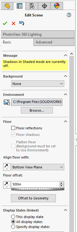

I want a plain white background (None) and no floor reflections or shadows. I edit the scene, setting Background to None, and unchecking Floor reflections. I do not have the option to uncheck Floor shadows as it is grayed out (???). And then I make sure it is set for All display states. I save this as my Part and Assembly templates.

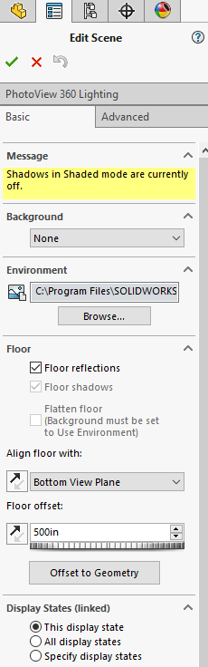

However, when I start a new part or assembly using these templates not all of these settings are kept: Floor reflections is checked and the display state is set for This display state.
How do I make my defaults a) have None for the background, b) have no floor reflections or shadows, and c) apply to all display states?

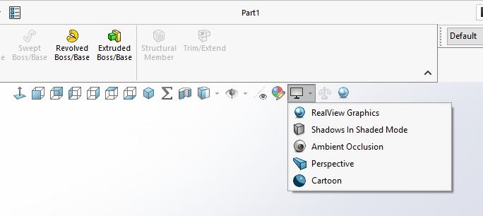

Lol I have a feeling this is graphics related. You do not have the “Realview graphics” button in your bar and that is one thing that generates those.
I’ve found something that at least gets me past the immediate aggravation, but I still do not understand why the templates did not save all the scene settings.
AlexLachance mentioned Realview graphics. It is greyed out for me and I can’t find anything that explains that in the SWX Help. (Perhaps because I don’t have a high-end officially sanctioned graphics card I am not allowed to use Realview graphics?! I dunno fer sure.)

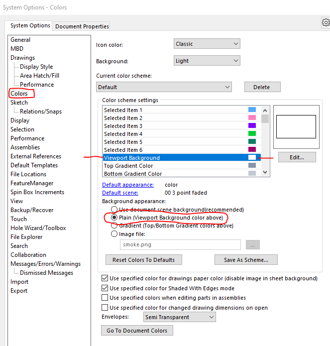

However, in searching for that I poked around and found this SWX setting:
This gives me the plain white background I want. However, if I do try to edit a scene I am forced to change this to “Use document scene background”. The funny thing is that I tried to make the document scene background white, but it shows with an Image instead of None and the Floor reflections are checked.

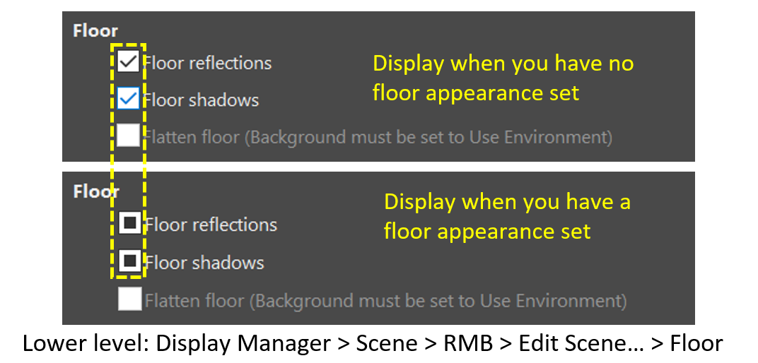

I’ll call this one the “Lower Level menu”

  1. Suppose you have a floor appearance, either directly from the scene file, or applied directly to the model/template that is anything other than the implicitly added and hidden shadow floor.p2m or reflective shadow floor.p2m mentioned in #4. Then manipulating the checkmarks via the lower-level menu is strange (see the lower-level image above). Whether or not floor shadow or floor reflection is actually active in your scene, you will find both set shown as filled-in squares, rather than on/off checkmarks. If you click in attempt to manipulate the lower-level settings, you will get a warning that these settings are coming from a floor appearance file, so any changes will force the removal of the floor appearance. However, manipulating the settings via the higher-level menu work as expected (modulo the bug from #3 where you need to edit the scene and click ok for the new settings to be saved with the file. This inconsistency is at best a quirk.
