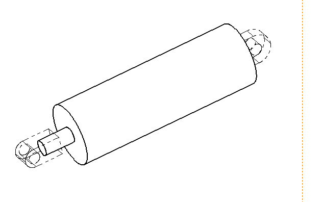

The best case that I would like to see is for the drawing to show those removed components in some dotted phantom line font and for them to be transparent so the parts behind them are shown, not as hidden but normal visible edges. It would be really slick, I think, if this could be driven from the Assembly where I can group those parts in folder or envelop or something.

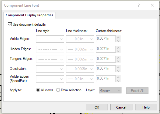

It may be slightly tedious, but you might be able to do it in the Drawing by right-clicking on the components (either in the drawing view or tree) and selecting “Component Line Font…” from the drop-down. You will adjust the line style and thickness for Visible Edges for the “ghost” components and Hidden Edges for the components behind them.

Right-click on the component (again, either in the tree or drawing view) and select “Show/Hide > Show Hidden Edges.” If you have used the component line function referred above to have the hidden edges of these components the same thickness and style as visible edges it should show just like it would if the ghost component wasn’t there.

Yes, there is a global setting for line types for the whole document, but as I said above you can override that by right-clicking on a component and choosing “Component Line Font…” from the drop-down. That will open a dialog box. De-select “Use document defaults” near the top left, and then you can select the desired line style and thickness for various line types.
If there are multiple instances of this component and you only want this change to affect the one you selected then be sure to select “From selection” near the bottom. Otherwise it will affect the other ones also.
