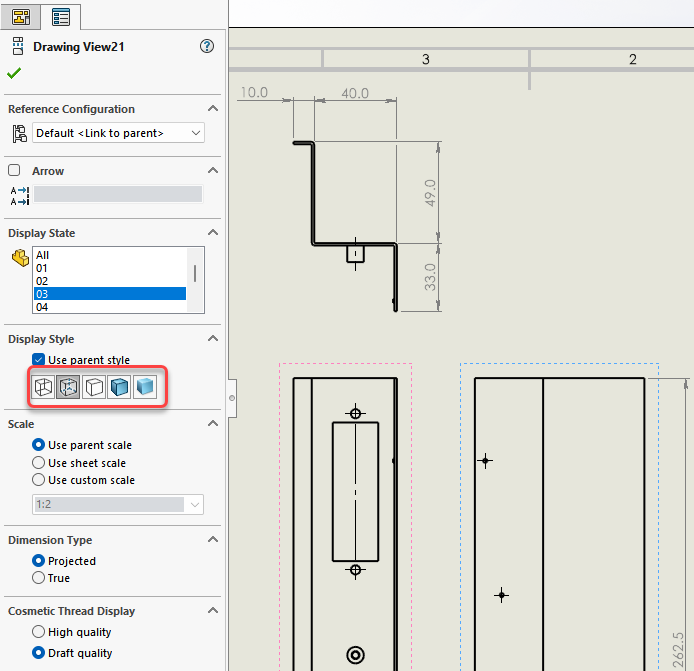

I’ve seen so many weird things in Solidworks, but this one is the worst. Following @Glenn Schroeder’s advice, copying and pasting the view solved the problem. I have no idea why copying and pasting the same view, shows the hidden lines, while the source view doesn’t show it.
Glenn million thanks. I really appreciate your help.
Most likely, they were stuck in “draft quality” and weren’t updating themselves for some unknown reason.(Even though they show as high quality on your screenshots)
