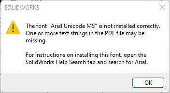

When I try to save a drawing as pdf I receive this error:
Searching help brings this up :
I have Office 365 installed. I don’t really think Windows 10 or 11 allows installing Office 2013 and I don’t even can find a shop selling it.

Can you try changing to a different font? It may not be a long term solution, but might point you towards the source of the problem.
I don’t have used this font. I think Solidworks is trying to change used fonts to Arial Unicode MS and it can’t find it.

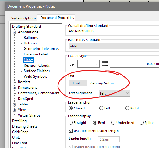

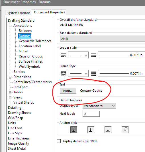

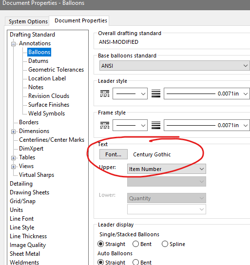

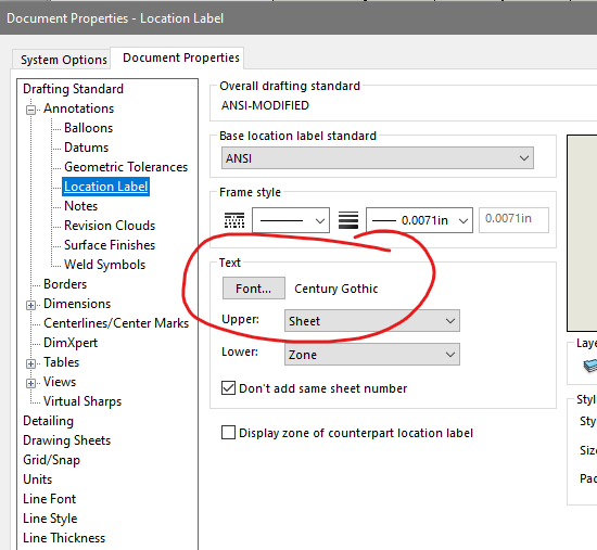

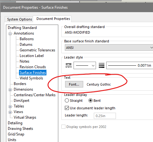

Did you check these places?
Etc…
And that’s just for annotations. Doesn’t include the Dimensions, Tables, Views, or Sheet Metal areas of options.
Lots of places to check.
I searched for Font in options-Document Properties.
I received a long list, but everything was set to Century Gothic.
