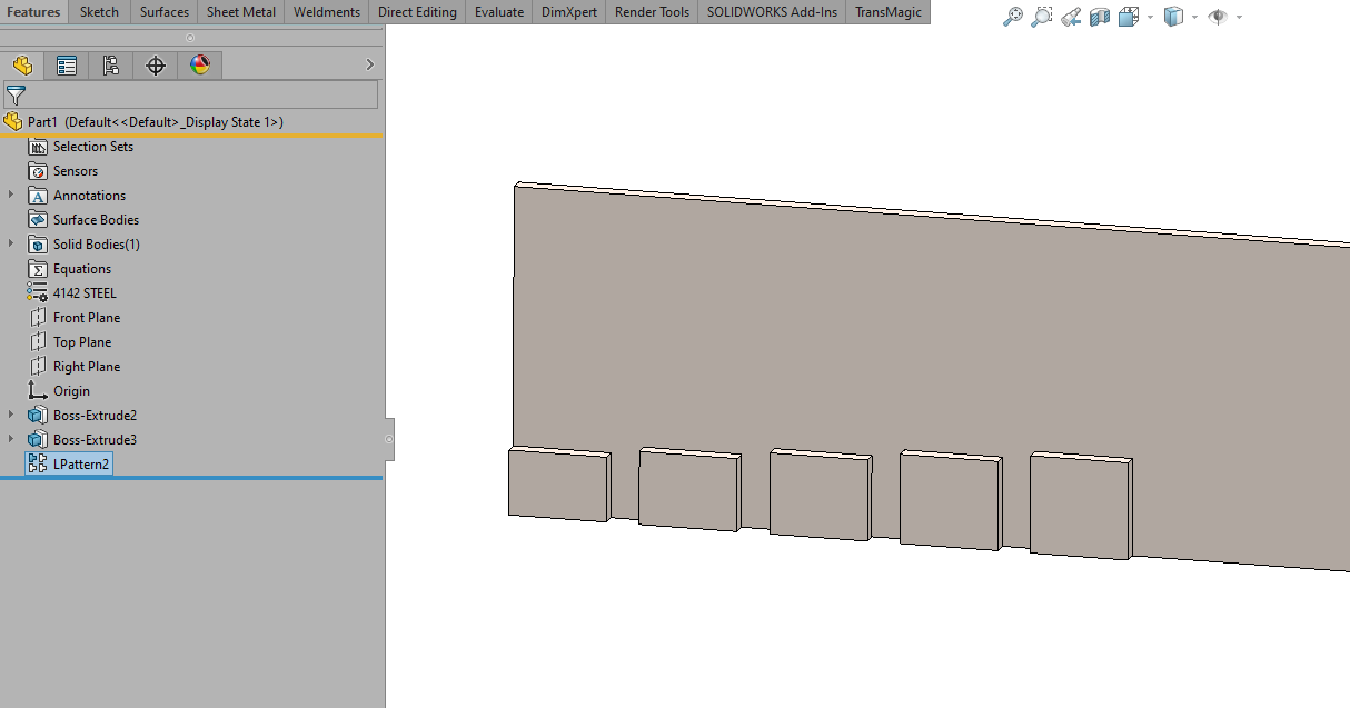

If you want to vary the dimension, and you want to, in the end, extrude them, then extrude the rectangle, then pattern it. Feature patterns allow you vary specific dimensions.
