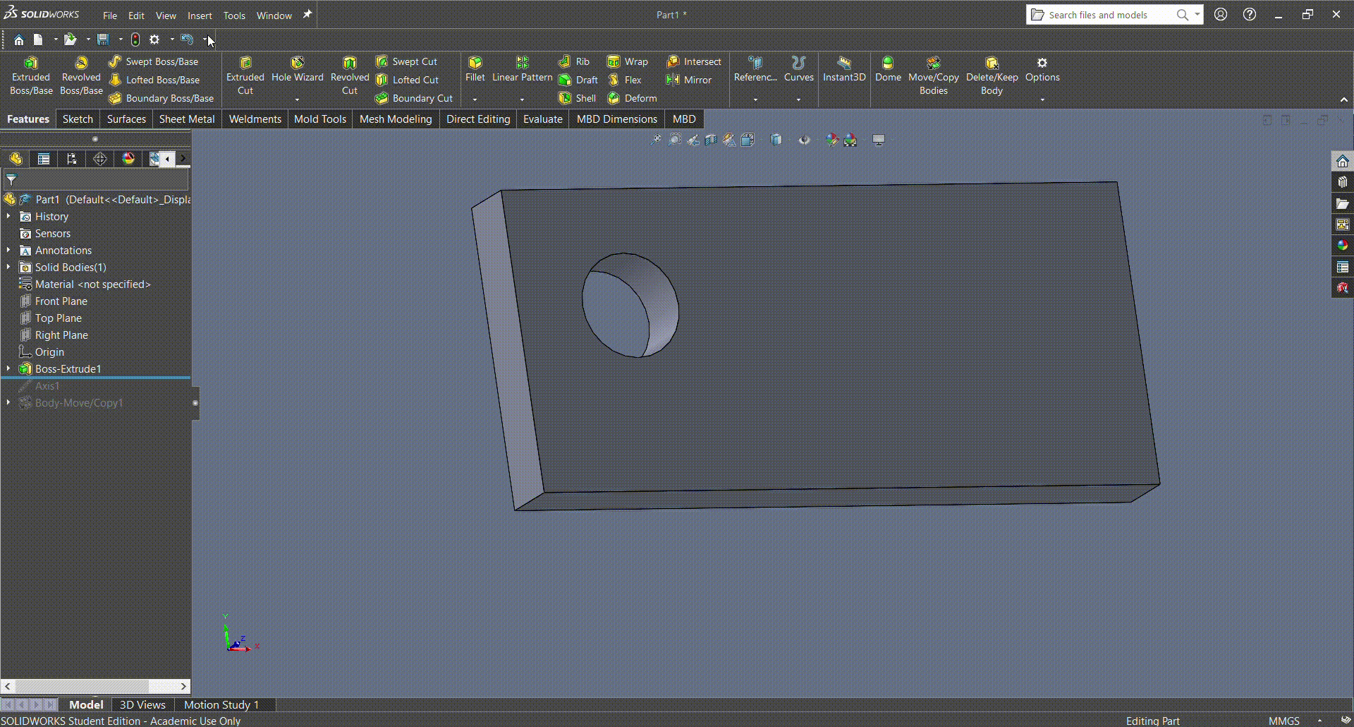

How to mate center point of circle of imported body to a plane in the Body-Move/Copy feature
I just want the center of the highlighted circle coincident with the Front Plane. I cannot figure out how to select the center point. I tried using construction element like point or axis defined by the circle or cylinder in the imported body, but the move body mate will not let me select it.

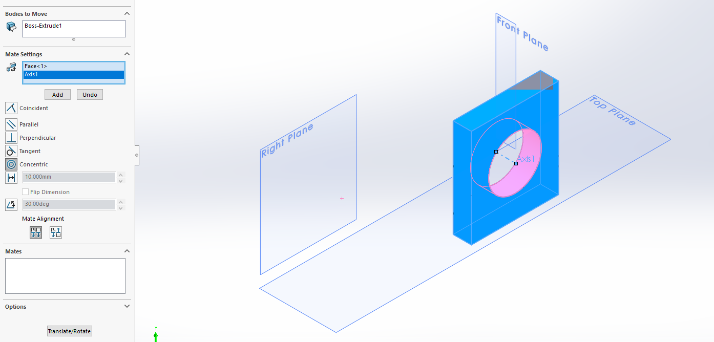

I am able to mate it by selecting the circular face of the hole and a reference axis
After that i use a 2nd move command to constraint it to other plane (since i only want the hole to be coincident to the front plane)

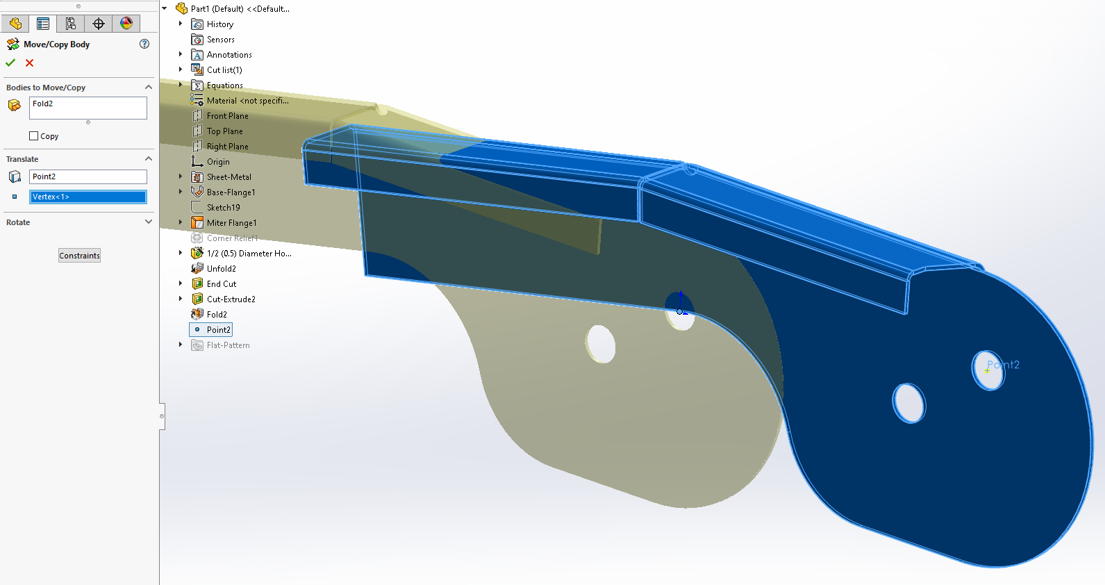

This strange behavior occurs because SW relies on history to build models, so you can do crazy stuff like this:
It works fine on assemblies tho, because the reference will be attached to the part

I was trying the first half of that. I added the axis like you did then tried to move the body by putting a mate between the axis and a base plane. Didn’t work, wouldn’t let me because the axis is not part of the body.
What you showed seems ridiculous behavior to me, but once a user knows how SW behaves then it could be useful I guess. I’d still feel a little dirty actually doing that though. IMO that type of move should NOT have history.

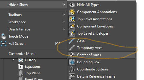

There is no need to create the axis. All cylindrical features have an axis. Solidworks calls them “Temporary Axes” and hides them by default. To show them, go to Tools, Hide/Show, Temporary Axes.
That’s good to know. Thank you. Unfortunately, it is not selectable in the Body-Move/Copy command.

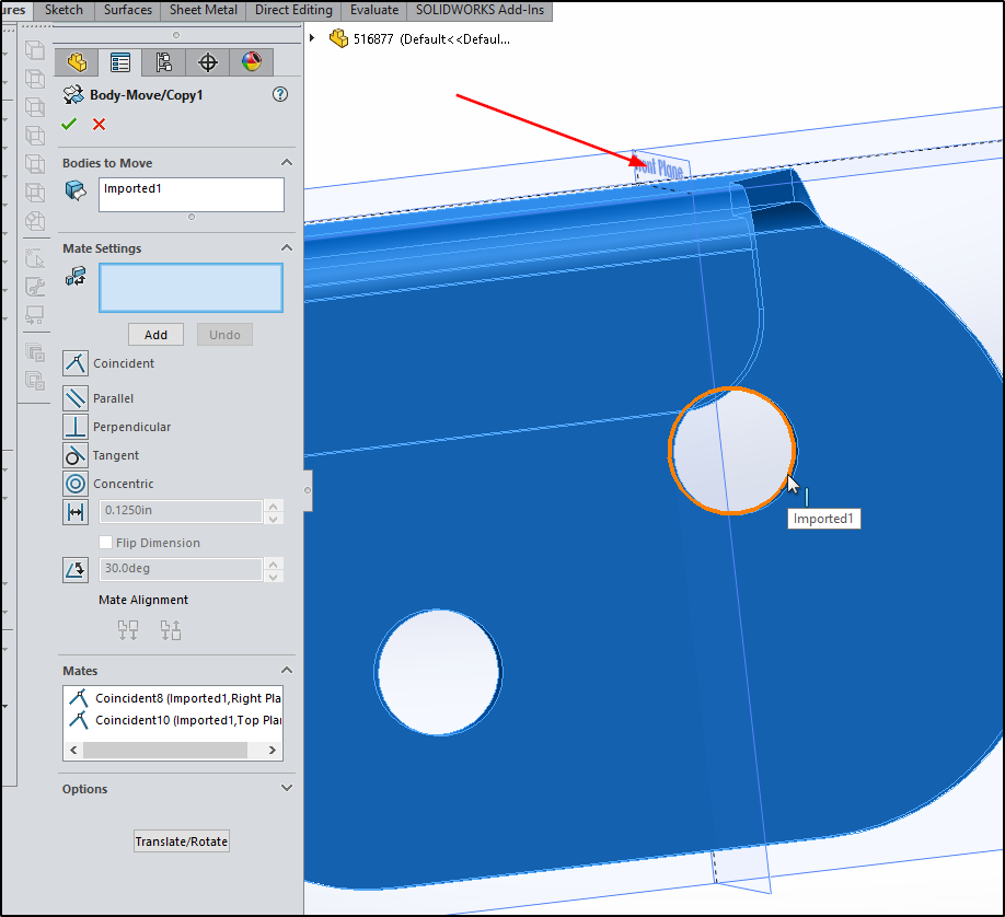

The “Move/Copy Bodies” has two methods of use. A “Mate” like method that was added back when multibody weldments was added, and the older “Translate/Rotate” method.
It’s stupid but the “Mate” method forces you to select model geometry as one of the selections. You can’t pick the holes axis, sketch point, or reference point and then a plane or other reference geometry. One selection must be a face, edge, or vertex of the model. What rational there is for this, who know? I guess the use case never came up.
The “Translate/Rotate” does allow a point to point selection. Like you said, you can’t select a hole center point like SE, so you have to add one (Reference point or a sketch point).

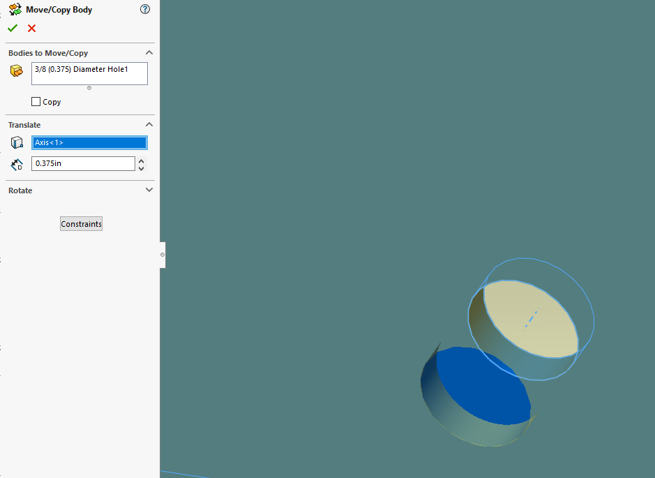

A temp axis can be selected for body move, but since it’s a vector, you can only move along the axis, so the PM changes to a distance spinner:

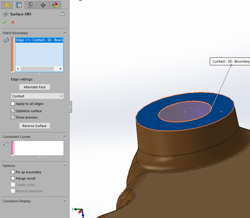

If the issue is because the software simply isn’t seeing the circular item as circular, then you can you create a temporary surface to get you a center point and an axis (if you need it)
Then create an axis (if you need it)
