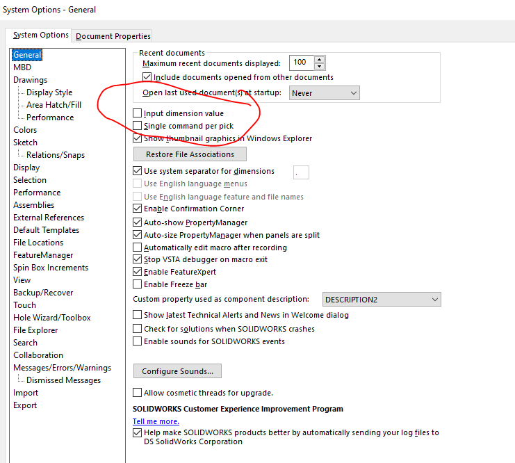

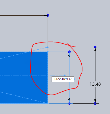

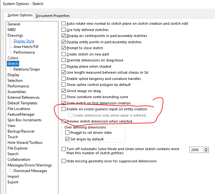

This thing just reappeared, probably related to yesterday’s Windows Update. How can I make it go away? All the right things are already disabled in System Options.

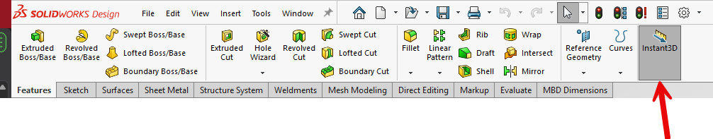

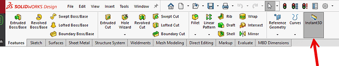

Uncheck the Instant 3D button.
Many thanks!
