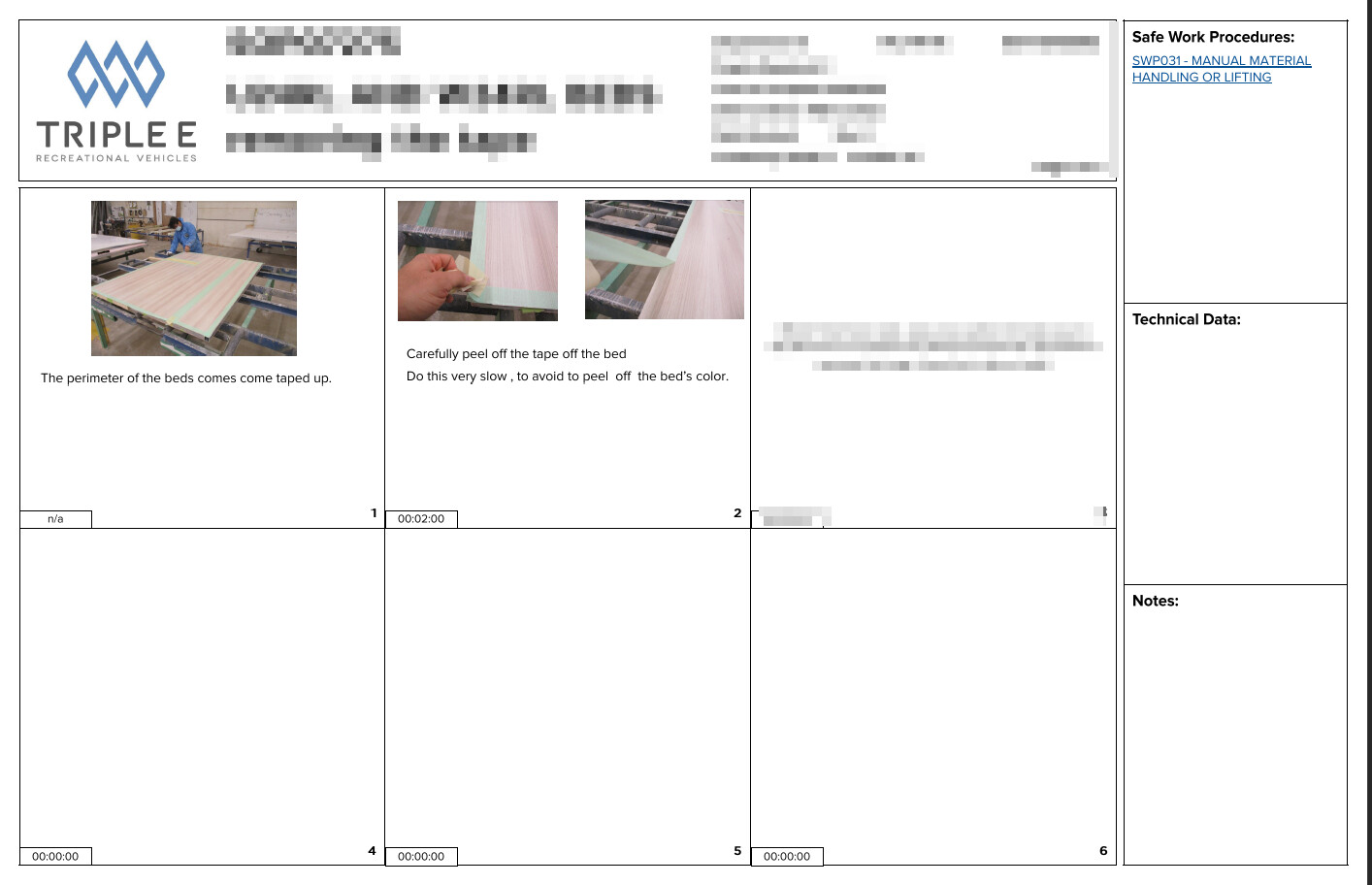

We looked into composer too but it’s incredibly expensive (you also need to train people to use it properly which is an underestimated additional cost). For our in house production we mostly use standard operating procedures that are put together not by the design department. They use photos & text (MS publisher - I would use something else though) and work with screenshots from the model or photos from the actual assembly. Very rarely we need to make an exploded view for them where they draw in some notes.
We do not use videos. Videos are great if you do it for the first time - but afterwards you don’t want to spend the time looking through a video to find a specific assembly step.
I cannot post something more detailed due to policy reasons - but maybe this helps:
