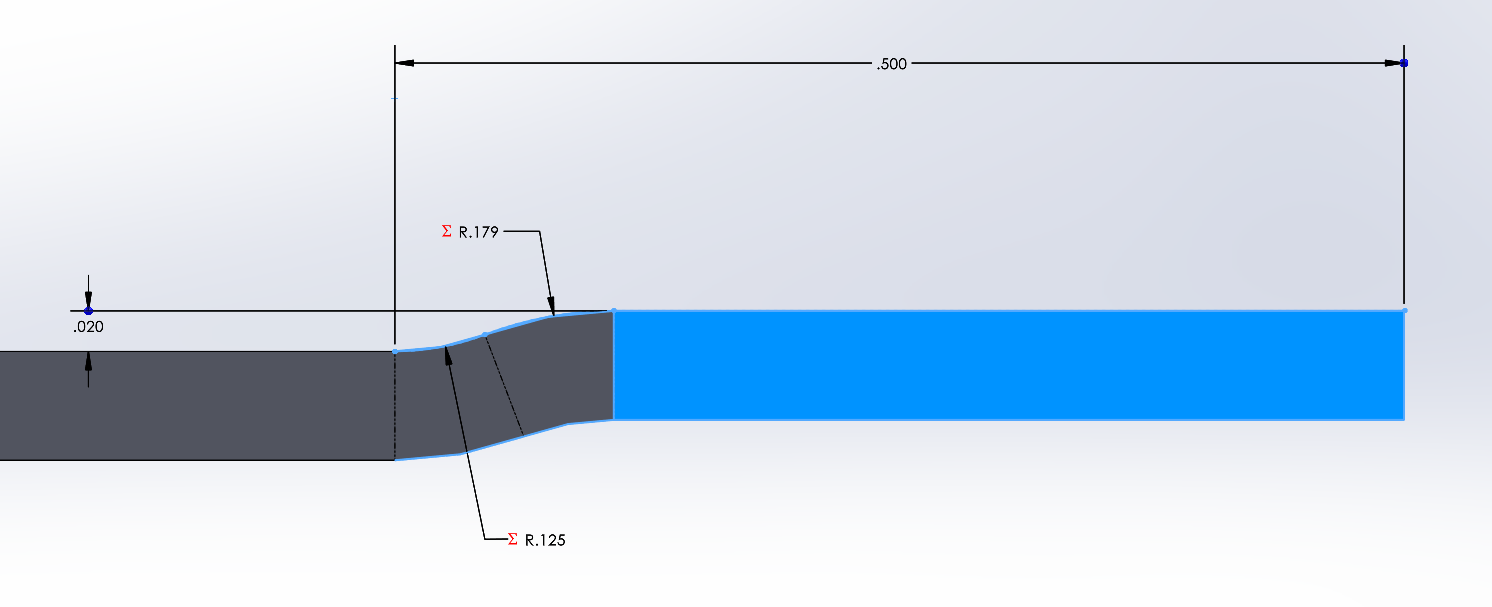

I cannot figure out how to make a jog where the offset is less than the thickness, nothing I have tried is working and I’m out of ideas. I even looked at the help page, it was most generic on the topic.
Thank you.
Thank you.
Make sure your angle is shallow enough that the bend radii don’t interfere. If that doesn’t work, uncheck “Fix Projected Length”. (Not sure why that last one makes a difference, but it does sometimes… )
But I want the projected length to remain the same. Looks like toggling that off, then setting the angle then turning it back on works. seems really stable
It appears that SW “jog” fails if the bends touch, ie there must be some flat between them. Which tells me the “jog” feature is a glorified macro that combines two sketched bends?
The Jog feature isn’t even 95% done, more like 75%. It likes to fail because it’s derived from its cousin The Sketch Bend, which is the least stable sheet metal feature in SWX, at least IMO. Jog also tends to change face IDs at rebuild, even if nothing in it ever changed.

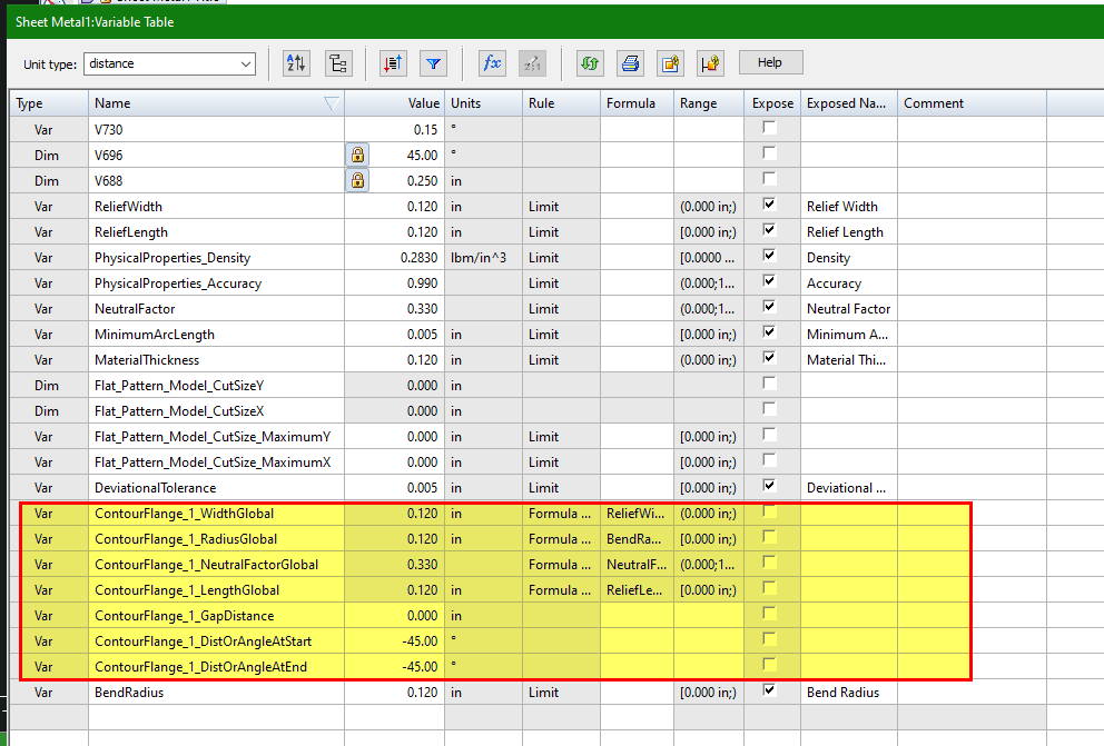

How do I see all the variables for features? Can they be shown in the Equations. Global Variables and Dimensions dialog?
With a flat tab and an edge flange in both SW and SE this is what I get:
SW:
SE:
See how all the editable attributes of the feature can be edited from the Variable Table? In SW only dimensions placed by user are shown. When you want to edit stuff without going into the sketch or feature is this how you do it in SW? I used the variables table fairly often in SE.

What you have selected (3rd button - dimensions) shows all of the variables for all features. I usually name them to make them easier to find.
SolidWorks only makes a global variable out of “Thickness” for some reason. So I double click the Sheetmetal feature to show it dimensions, and right click the radius dimension and select “Link Values” and call it “Radius”. You can link other dimensions to it or use it in an equation.
The other things SE is showing appear to be items that are located in the Cut list in SWX.
I’m not following. “3rd button shows all of the variables for all features” it doesn’t show the variables for the swept flange 1 feature (screen shot). It only shows sketch dims (twice for some reason) and a couple sheet metal object properties. I’m not seeing the properties/variables that are in the feature settings.
So to edit feature properties/variable (highlighted in screen shot) from variables table I need link them to global variables?
