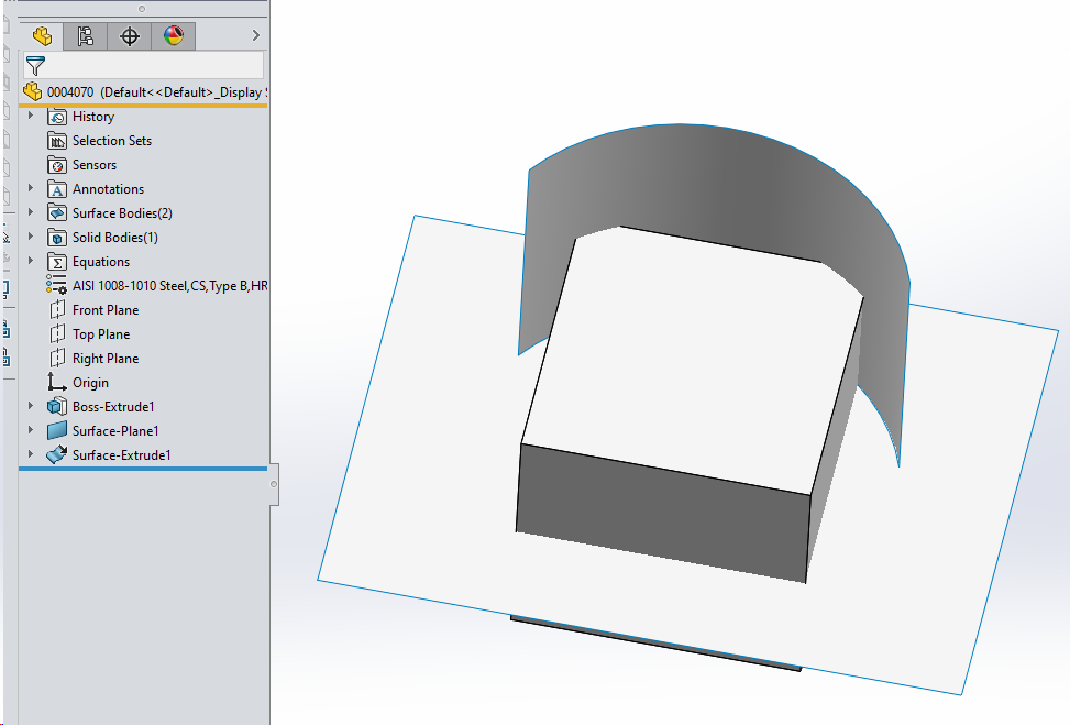

What I’m saying is that SOLIDWORKS normally ignores surface bodies when creating drawing views. If I have this model with a solid extrude, a planar surface and an extruded surface:
and I create a drawing view of the model, by default, the surfaces are not visible:
The only way to make them visible, is to use Tools…Import…Model Items or by right clicking on the surface feature in the drawing feature tree and selecting Show.

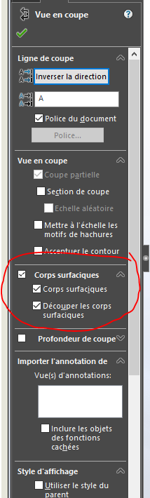

If the issue happens in sections, then this is most likely the culprit
It has nothing to do with the problem that the dialog is in French…
That’s the main concern actually :laughing:

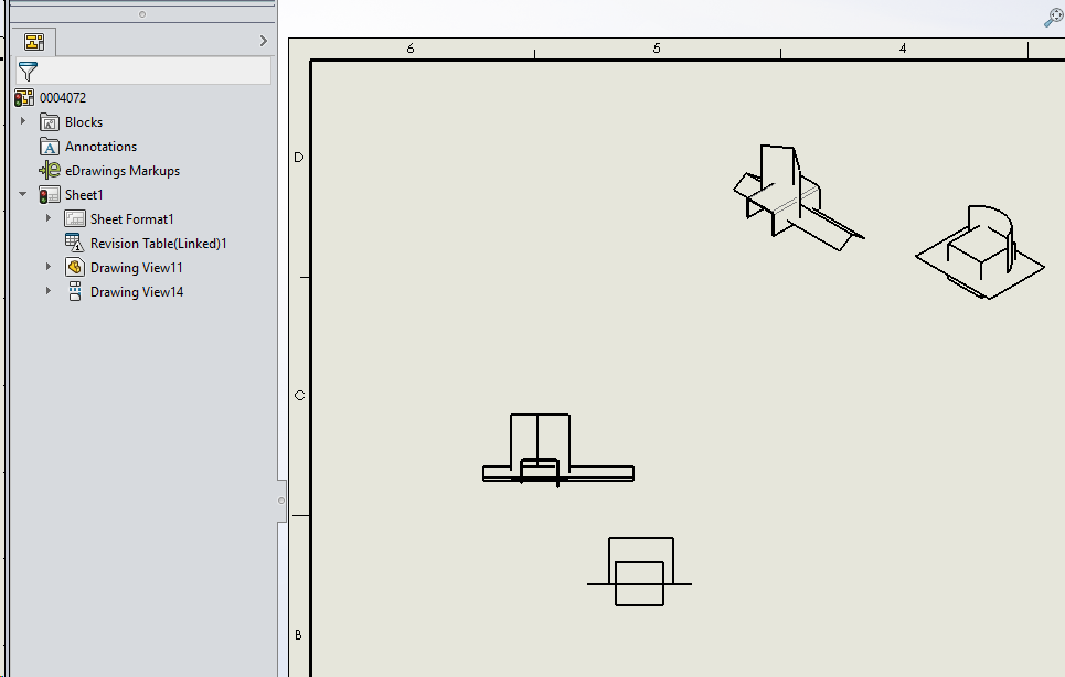

I see now. Repeated what you did, also tried in sheet metal for fun; same behavior as you show. Then put those two models in an assembly and made a drawing of that. Drawing of assembly shows the surfaces by default.
I’m trying to figure out if when I hide the surface in the assembly if the change is affected in the part file or assembly file. In other words, hiding in assembly means hiding in model too and the assembly is just showing what’s in the model. It seems so because if I have the assembly checked out but not the part file. Then hide a surface in the assembly, save assembly and close it. Then open the assembly the surface is shown again. I thought if I’m in the assembly and hide the surface there it has nothing to do with the part file, I dunno.
Then I tried figuring out what the drawing is doing but it’s just inconsistent now. I have two views projected from the same base view, managed to hide a surface on one by hiding it in the assembly and it stays hidden but when I made another projected view the surface is back again. I’m getting into bad flow with the test drawing of assembly, time to restart sw.
and the drawing after trying to hide in assembly, this is after a ctrl+Q
