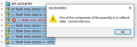

How to find rollback'd component?
I’m trying to ‘form new sub-assembly’ but get an error :
Cannot add: one of components in rollback state.
So, couple thousand parts, how do I find the culprit without having to open every part?
you’re saying that assembly “TEMP-DWG-00023…” contains a couple thousand parts? If not should be able to drill down through sub assemblies there to find the offending part.

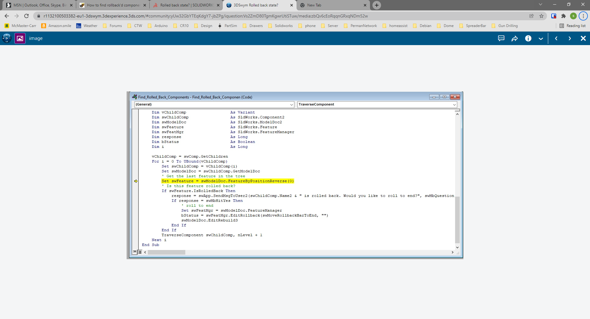

Here is a macro that does it for you:
https://forum.solidworks.com/thread/8497
Maybe it will work?
Haven’t tried the macro. Company PC, so we’re locked out of a lot of stuff like that.
I ended up trying ‘form new sub-assembly’ while deselecting one assembly at a time until I did not get the error. Then I went to the offending assembly and repeat. drilled down about 6 times to the final sub-assembly with parts. Checked about a dozen parts and found the bugger. About 15 minutes, but what a pain.

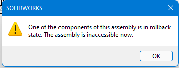

“One of the components of this assembly is in rollback state. The assembly is inaccessible now.”
…has been happening all day… only have a few components in the asm but what a pain in the butt!
No rhyme or reason… lame! grumph
I fought that same problem last week. Would it really be that difficult to tell us which part is rolled back?

For some reason that download doesn’t work for me. It says the zip file is invalid. Can you share it another way?
See attached (I was able to download it, so I attached it here)
Edit: Never mind, it says that the zip file is invalid. Give me a few.
OK, here it is (see attached)
Find-Rolled-Back-Components.zip (11.1 KB)
Thanks. Unfortunately I’m having the same problem as the users in the other thread.
I think my problem is that no part is in a rolled back state, but SW thinks it is. From the other thread:
"Here is some discussion on why SW might display the rolled back message when nothing is actually rolled back:
https://forum.solidworks.com/message/143780 [This link doesn’t work for me]
(possibly related to using configure dimension while editing a sketch)"
I definitely have a few dimensions whose value changes based on the configuration.
