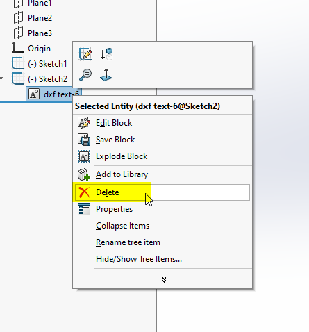

With the ‘Delete’ command? Unless I’m misunderstanding what you want to do.
Hi, Thanks for the quick reply. But that’s not quite what I’m talking about. I’m talking about the imbedded block.
The command you have shown will delete the block from the sketch but not the part. For example if you edit the block and then delete it, then re-drag the original DXF file into the part again, solidworks thinks “oh this block’s already imbedded into the file, I know what I will do I will use the imbedded file” and that file is edited. So you can’t drag the dxf file in again because an edited version is imbedded into the part file.
This is why I want to remove the imbedded file/block.
You have the same issue with drawings but the Block folder in the feature manager tree lists all the imbedded blocks and you can select the imbedded block and delete it. There is no block folder in the part (not sure if this is a 2021 bug). I do have block folders set to show in the feature manager settings but this only effects drawings.
