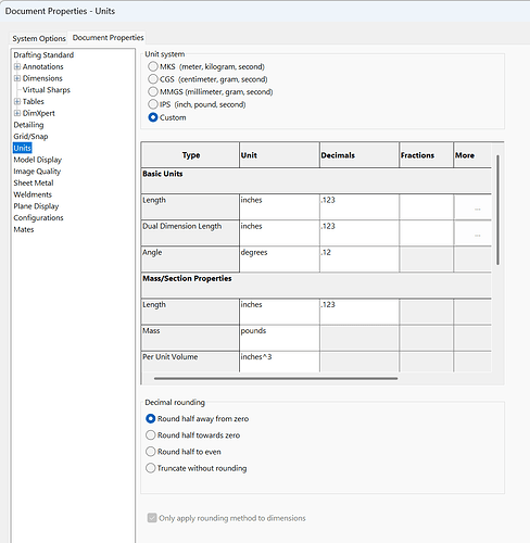

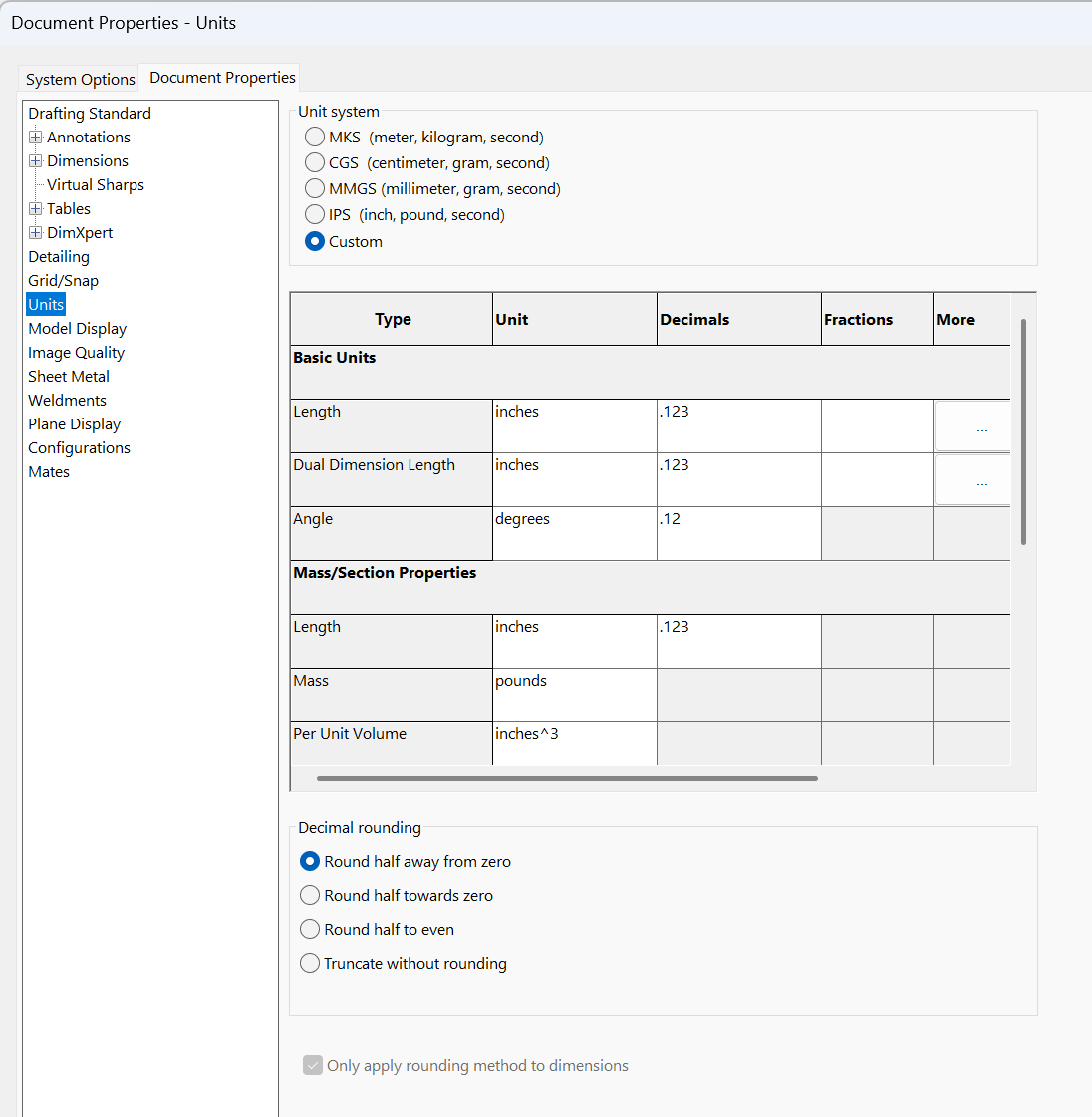

I do not seem to have a “Decimals” option for Mass.

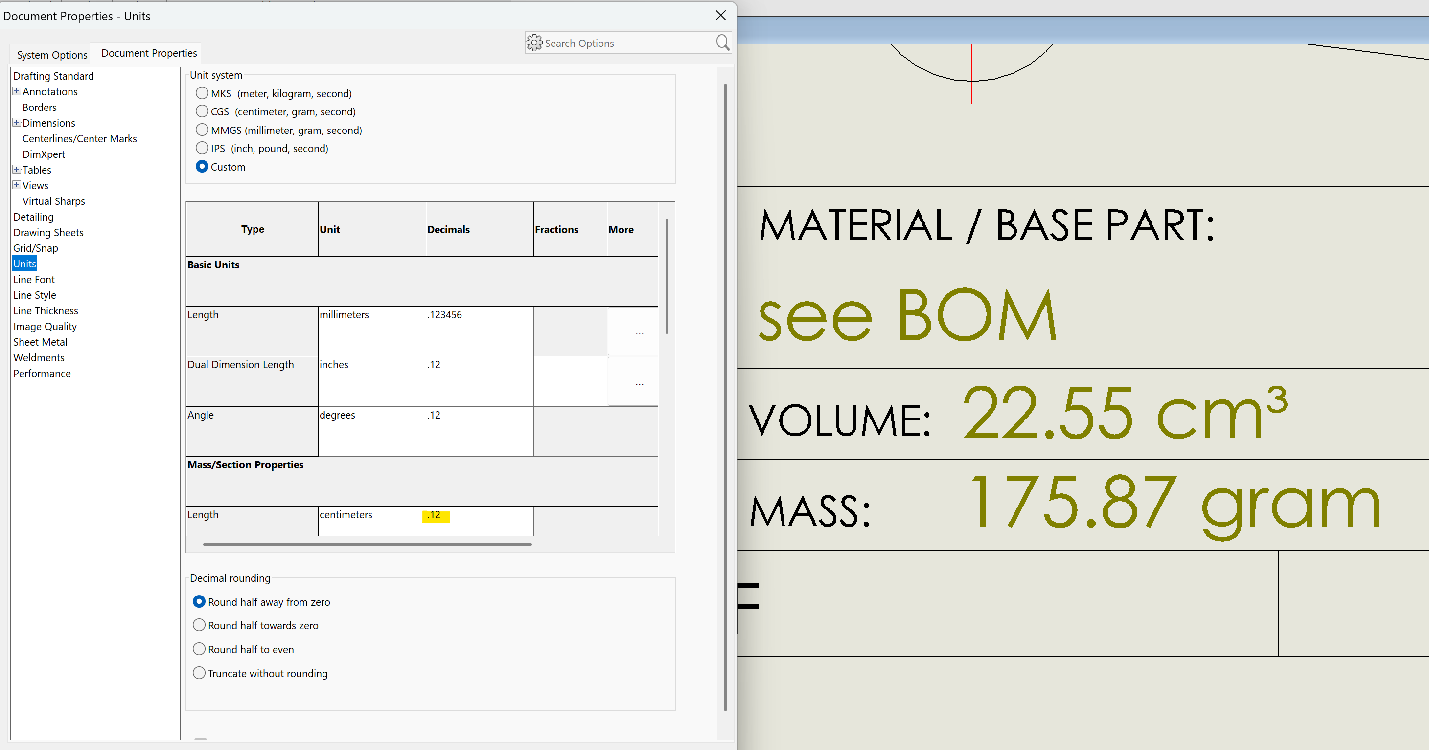

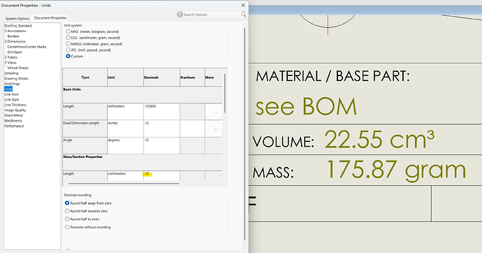

Time to try that enhancement request. The mass runs off the main length decimals. As you change that the weight should update.
Got it.
OK, thanks for the help.
