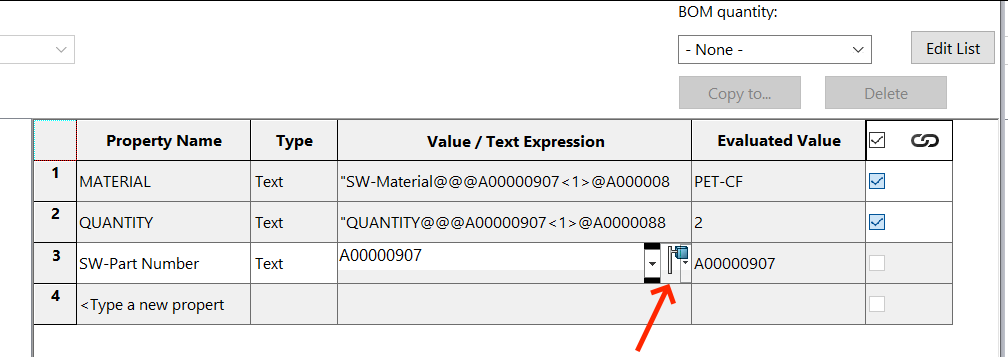

I want to add configuration-specific Cut-List item properties, so they would appear like this:
By default, accessing ICustomPropertyManager from Feature won’t allow me to specify configuration name:
