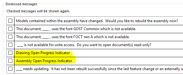

I could use this information now, and I have apparently dismissed this message. I am not seeing it my dismissed messages in System Options. Anyone know what this is called?

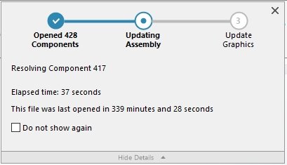

Assembly Open Progress Indicator:
Sometimes, the counter keeps rolling if you don’t close the window and you end up with numbers like that. I don’t know what makes the counter keep on going though.
Didn’t have that one listed, but there was one listed for “Drawing open Progress Indicator”. That seems to have done it.
There are individual dialogs for each document type:
