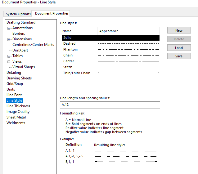

It’s in the Options menu on the Document Properties tab. I’m not sure what the standard units are but I would guess mm.

It depends on what type of line we’re talking about. Are you talking about model generated lines? Those are document properties. They adjust according to view scale.
If you’d like to change them for a specific purpose, you can use the line format toolbar to set them manually one by one. In the following Image I put the highlighted line in dashed manually. You could have the line be thicker too

That is exactly what I need. Thanks!

the line scale in Solidworks is automatically adjusted with the scale of the views, so you should never have to adjust them like you do in Autocad. They are usually set by the standard you pick (ANSI/ISO), but you can modify them in document properties. I have never modified them in Solidworks like I have to do in Autocad all the time when I work on large or super small items.
