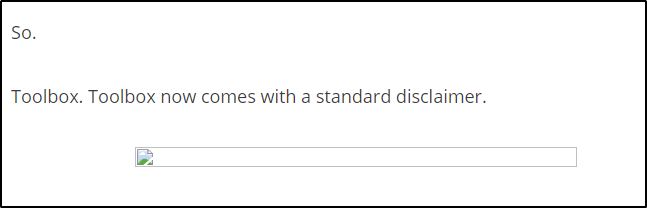

Hope you don’t mind posting a screen shot of one of your blogs here: If this is a joke, I think I get it, and made me chuckle.
Continue reading, nope, looks like other image links were broken too. Anyway, aside from the blog that is an excerpt from the sw bible on toolbox most shine a negative light on toolbox for multi user environment.

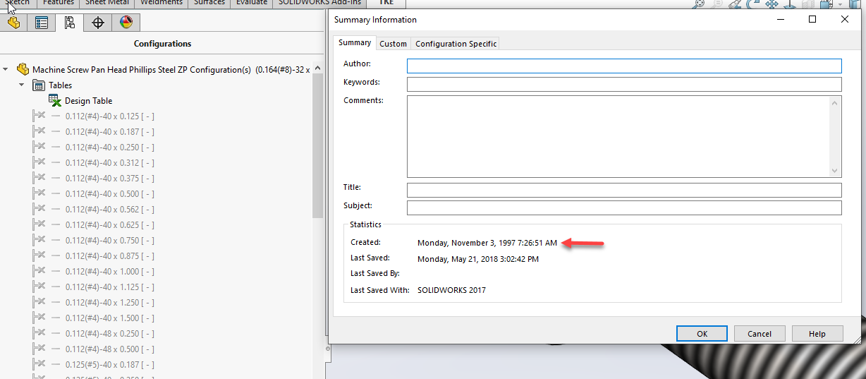

Our fastener files are over 20 years old, most were created in 1997-1999
