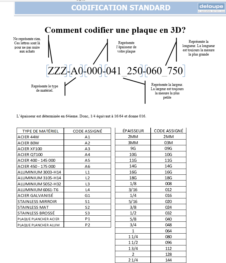

For brute materials, such as plates, flat bars and iron angles being cut, we use a different formula that goes with the ERP number and carries the length of the part in it’s name. So for example CR401-15_000 would be a cold roll pertaining to the first folder of the CR4(Cold rolls) with a length of 15".
For plates, we use a long ass number that gives the material type, the thickness, width and length. Here’s an image that describes it quickly.
ACIER = IRON
EPAISSEUR = THICKNESS
I think the rest is easy to figure out.
