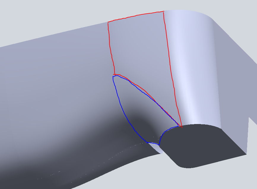

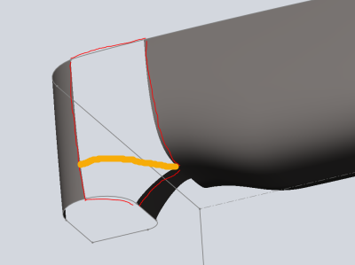

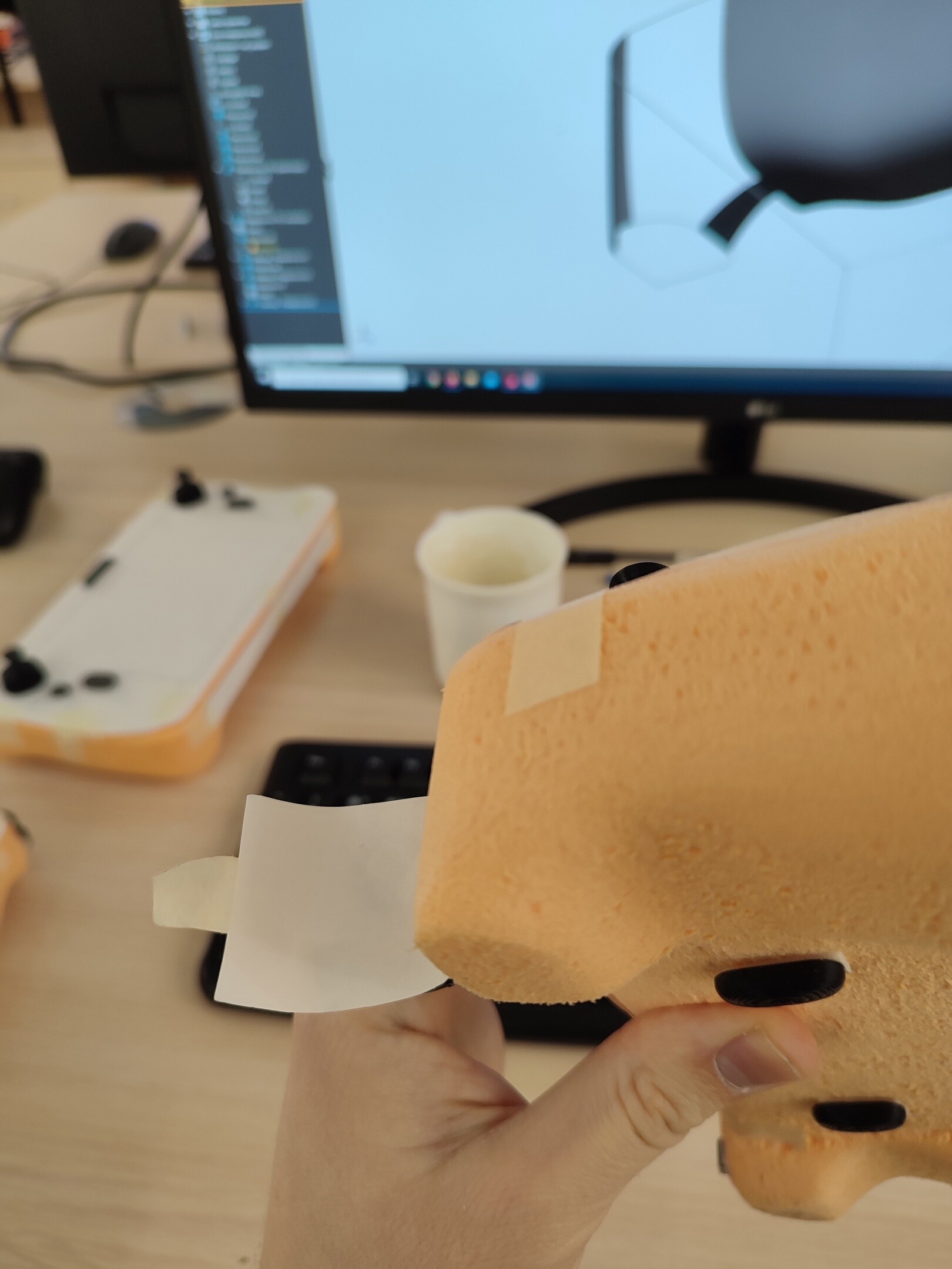

Hello everyone. I’ve been trying to solve this puzzle for a while. I am making a model similar to a game controller. What I need to do now is create a smooth transition between the three surfaces and two sketches that are shown in the picture. The result should be as on the reference photo of a handmade prototype. I found two ways to make something similar to what I wanted, but the result doesn’t allow me to impose tangency so the surface has noticable creases. The first way would be to fill the area with two boundary surfaces (example 1). The second way - to create interstection curves between a plane and the two surfaces and draw a spline tangent to the curves. But then I can’t figure out how to smoothly fill the lower gap (example 2). Could anyone give a hint on how to build this surface in a better way?

Use a Fill surface. That should get you where you want to go, assuming your existing surfaces are consistent with themselves. You may need to set up reference surfaces at the sketches for tangency direction, but you’d need to make sure that the reference surfaces are also consistent with the rest of the surfaces.
Many times when features like this with tangency or curvature specified all the way around fail, it is because the adjacent input surfaces are not tangent with one another.
Divide such that you have two 4-sided regions.
Even better if you divide to match part topology.
Fill is a last-ditch gambit to be avoided.
Thank you! Don’t know how I managed to overlook the fill command, it gave me a perfectly smooth result.
Thanks! Will try it out! Could you explain why should the fill command be avoided? It doesn’t give much flexibility, but for me it did the job.
Splitting the job into multiple features just adds additional sources of error. Making additional acute angles is also often problematic. Some people don’t like that the Fill doesn’t match the existing UV flow of surrounding patches, but I’m ok with that as long as it gets the tangency correct without puckers or other artifacts.
You can use guide curves and reference surfaces to help you gain control with the Fill. Check these out:
