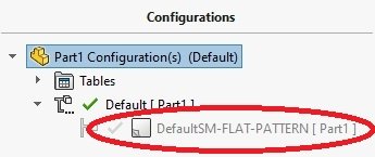

SM-FLAT-PATTERN
How does the FLAT-PATTERN configuration work? Does it have any identifiers other than the keyword in the name “SM-FLAT-PATTERN”? How can I find out this configuration FLAT-PATTERN, other than a substring in the name?
This substring (SM-FLAT-PATTERN) may be different in different language packs, how can this be tracked?

If you know, show me how you get all the properties of a given configuration in order to accurately determine who it is? (some like GetConfigurationProperty)
Anyone losing their mind can name the configuration: “SM-FLAT-PATTERN”
There is nothing special about the flat pattern configuration. I think SW does automatically create it when you create a sheet metal part, but as you’ve found the name depends on the language installed, just like other features get named based on the installed language.
Additionally, there’s nothing preventing the user from unsuppressing the flat pattern feature in the Default configuration, or suppressing the flat pattern feature in the flat pattern configuration. So just because you’ve found a config with “Flat pattern” in the name doesn’t actually mean that the flat pattern is displayed. In fact, you could have multiple different configs of the part itself, each with its own different flat pattern config. I think your best bet will be to find the flat pattern feature in the tree. Iterate through the features and use GetTypeName2 until you find “FlatPattern”. You can then use IsSuppressed2 to figure out which config (or configs) it’s unsuppressed in. Or you can just unsuppress it in the current config.
Isn’t there something to call out if flat pattern is true in programming? I thought I saw this once
You’re correct. If you use GetBendState, you can check if it’s sheet metal as well as if it’s flattened or bent.
From what I have seen SW automatically makes a the flat pattern sub-config when a flat view is added to the drawing. We had go-round with this when people were making drawings for parts that had been modeled earlier and where not checked out. So while they had the drawing open all looked well and checked the drawing in. Then later others would open the drawing and the flat view was formed. While the drawing was being worked on, SW silently created the flat view config for the drawing, but is oblivious that the model is in PDM and not checked out (may fire the “File is read only” warning that most PDM users check the never show me again box.) so the model file is not saved or checked in with the flat config. Then when the drawing is opened that view cannot find it’s config and drops back to using “Default” or active config.
What is it you are trying to do with the automatically generated “SM-FLAT-PATTERN” config?
If you have the option “Automatically populate view pallet with views” checked, it will create the config for you when you start a drawing of the sheetmetal part.
The gist is this: the user runs the macro directly from the Assembly. Next, all components of the parts are searched at all levels, and if the part is made of sheet metal, then the DXF flat pattern file is saved. The user can choose: Save DXF for all configurations in the found part, or only for those present in the assembly. Accordingly, I need to create a sub-configuration of the FLAT-PATTERN, for configurations that do not have one, and for those that do have one, not to create it. And at the same time, do not create a sub-configuration for the FLAT-PATTERN sub-configuration.
Accordingly, the option that josh suggested is the most correct, I should not care about the name of the configuration a little more than completely, I should check the state of the “FlatPattern” feature.

I know about this feature for happy users. When we create a drawing for a sheet metal part, a flat pattern sub-configuration is created and only for the currently active configuration.
If before this I manually create a sub-configuration with the name as it should be for the configuration of the “FlatPattern” and do not activate the “FlatPattern” feature, then in the views palette there will be an unexpanded “FlatPattern”, that is, the software simply checks for the presence of the configuration and the name. It’s very easy to cheat.
your nested config structure scares me a little bit, but maybe it’s for a good purpose.
If you use the “SM-FLAT-PATTERN” config for dxf you won’t get bend lines. Save dxfs from the formed config if you want bend lines in dxf.

To find out if a part is made of sheet material, you should watch for the presence of “Sheet-metal feaтure” in the tree. “FLAT-PATTERN” will be visible in the Configurations tree only after you have placed a view in the drawing.
You mentioned that you were running a macro that looked at all parts in an assembly and exported the DXF flat pattern if it was sheet metal, so it doesn’t sound unimportant to you. Others were also discussing methods for exporting the DXF flat pattern so I described my method that is independent of whether a part actually has the derived “SM-FLAT-PATTERN” but is a sheet metal part. So, with this method, all you have to do is determine if it’s sheet metal since the export function creates the flat pattern derived configuration if it doesn’t exist.
The best method to determine if a part is sheet metal is the following IModelDoc2::GetBendState method. If it returns anything other than 0, it’s sheet metal.
https://help.solidworks.com/2017/english/api/sldworksapi/solidworks.interop.sldworks~solidworks.interop.sldworks.imodeldoc2~getbendstate.html
I guess most of us assumed you are trying to save a dxf of the flat from the model. Is that not what you’re trying to do?
If you are trying to automate saving dxfs of flats, that has little (possibly nothing) to do with flat configurations. The automatically generated “[parentFormedCofigName]SM-FLAT-PATTERN” configuration is just for the drawing view. We don’t save dxf from flattened configs as the dxf will not have bend lines which we like to have the UP and DOWN bend layers in the dxf.
So what is it you’re trying to do? Save dxfs from the part file or find a specific configuration for some other purpose?
Okay, I’ll be frank. Saving DXF is part of my macro, but that’s no problem. What I’m really trying to do is check the ASM to make sure the designers have done everything necessary for the project to be considered complete. Namely, I check all the components (Component2) of the assembly. For example:
If the component in all configurations is .IsSuppressed = True - why do we need it at all?
If .Visible = False, then you should pay attention to it.
And so on (.IsVirtual / .IsEnvelope / .IsFixed / ExcludeFromBOM / ToolboxPartType / IsFastener / NoBodyPart / Is Rollback)
Well, in addition to all this, sheet parts must have a dependent SM-FLAT-PATTERN configuration is flat, and also only one for each non-flat configuration.
