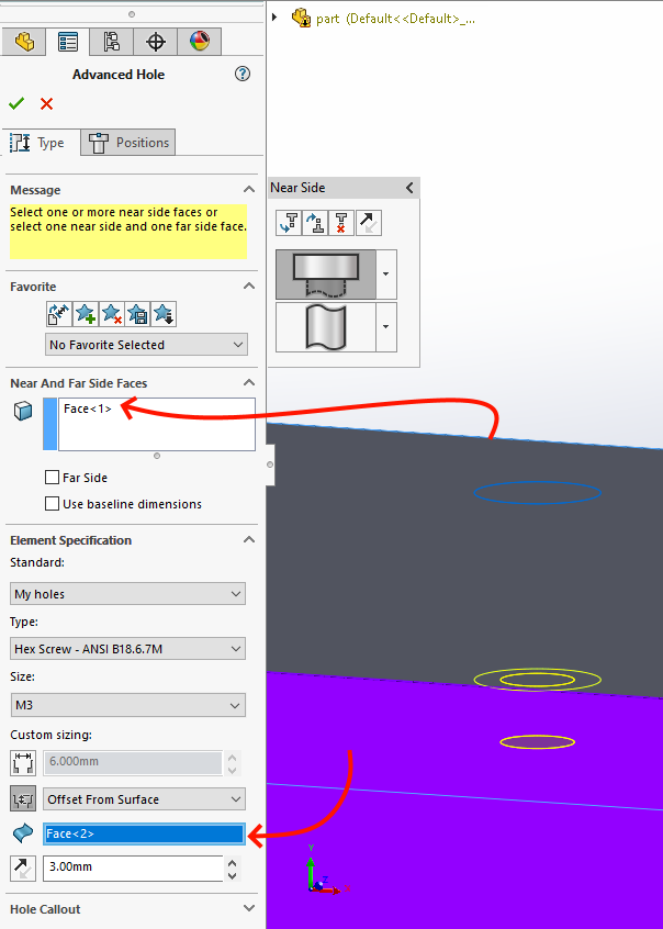

Now, Advanced Hole actually does exactly what I need here - it allows to specify counterbore depth from the far side by using Offset From Surface:
But the reason why I don’t want to do use Advanced Hole is because it does not support 3D Sketch for hole locations, while Hole Wizard does. If I need to create a whole bunch of these holes all around my part on different surfaces, doing it with a Hole Wizard and 3D Sketch means I have a single hole defining feature rather than separate features for each face, which saves a lot of downstream work (for example, it means I can use just a single Pattern Driver Component Pattern feature to fill all these holes with screws, rather than having to create multiple features for each hole feature).

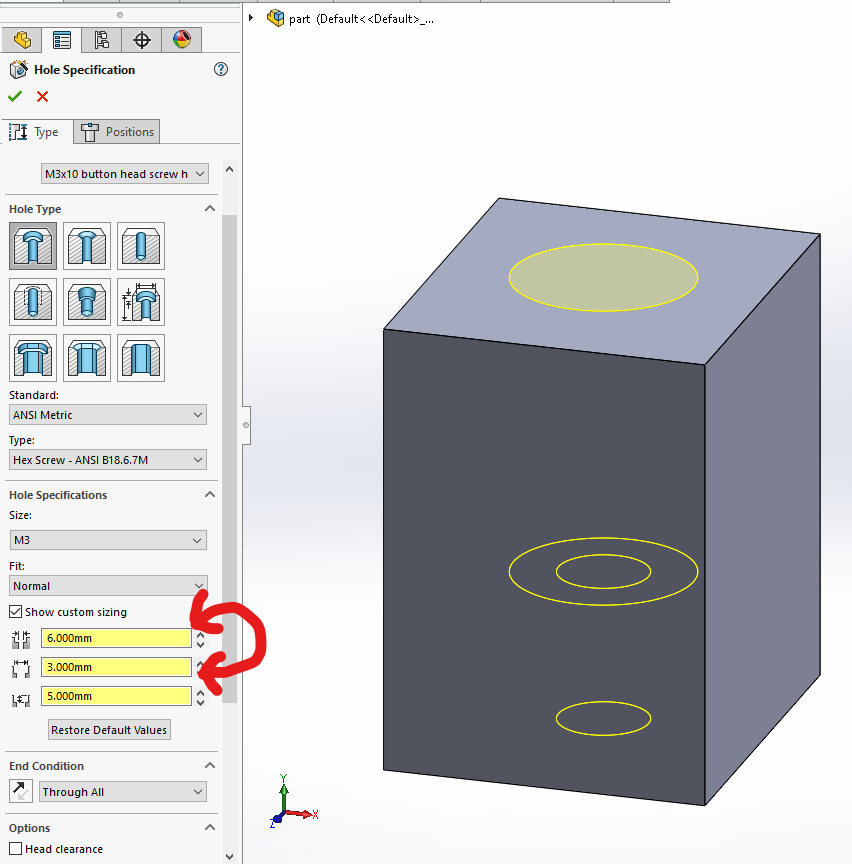

Okay, guys, I found a solution… A really weird one :smiley: Thought I’d share it with you if you happen to need something similar. So basically I realized that I could trick SW by placing the Hole Wizard positioning sketch on the bottom of the part rather than the top (so the hole is upside down), and then in Custom size, set Counterbore Diameter to hole size (3mm), and set the Hole Diameter to counterbore diameter (6mm). Basically just swap these numbers. With that, the last input (Counterbore Depth) now becomes measured from the bottom side of the hole, rather than the top:

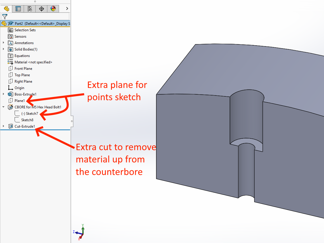

And… That’s it! Simple as that. I tested it out, and it works perfectly. The only caveat is that I have to remember to place Hole Wizard points sketch to the underside of the part rather than the top. But actually, this might be even better - ever had cases when the top surface is not flat, and you had to create an extra plane for Hole Wizard sketch, and then do yet another Extruded Cut to clear up material up from the counterbore..? Something like this?
Well, no more! With this diameter-swap method, you can do it in a single Hole Wizard feature, no extra planes or cuts required UU
