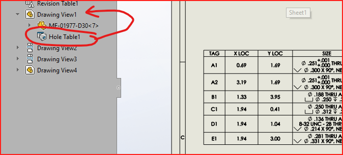

This may have been asked before (maybe even by me) but does anyone know how to add a view to an existing hole table?
Hole Tables are a per view type thing. Edit2: I was wrong. See below.
If you have second view, then you would need to create a new hole table.
edit:
If you copy and paste a view, it also automagically pastes a new hole table as well. (at least in SW 2022, anyway)
This is a table generated from 2 views (starting with Drawing View1).
It only lists in the main view of the Feature Manager?
I would like to add the holes from Drawing View3.
The only way I have found is creating a new hole table from scratch.
huh. I have tried selecting edges from other view and it won’t accept the selection.
Maybe it is because I used a copied view in my experiment. Hrmm.
AHA! There it is:
Thank you for proving me wrong! UU
