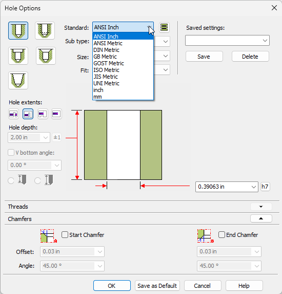

one of them is: I have the units set to Metric, when I put hole in the part and want to edit the hole the options box shows the dimensions in Inches,
1/ Why is that ? and
2/ How would I change it to show metric ?

Sorry, I was being thick… In the hole dialog, the units change based on the Hole Standard specified. If you specify ANSI Inch, the dialog is in inches, specify ANSI Metric the dialog is in mm. Has nothing to do with Units or Dimension Format. The Units are set in the Hole DB (Excel) for each Standard on the “Units” tab. This is what drives the Holes dialog field units.
FYI, you can enter other units (i.e. “mm” in an “inch” dialog) by entering the unit label after the value (ex. “10 mm” or “.25 in”).
