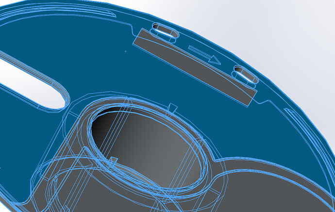

I changed something one day, and all of a sudden, when I select a face, the outline of the entire body highlights.
I’m sure this seemed like a great feature to someone, but to me, it’s dreadful.
Anyone have any idea what I toggled in v2023 to turn this on?
Thank you in advance.

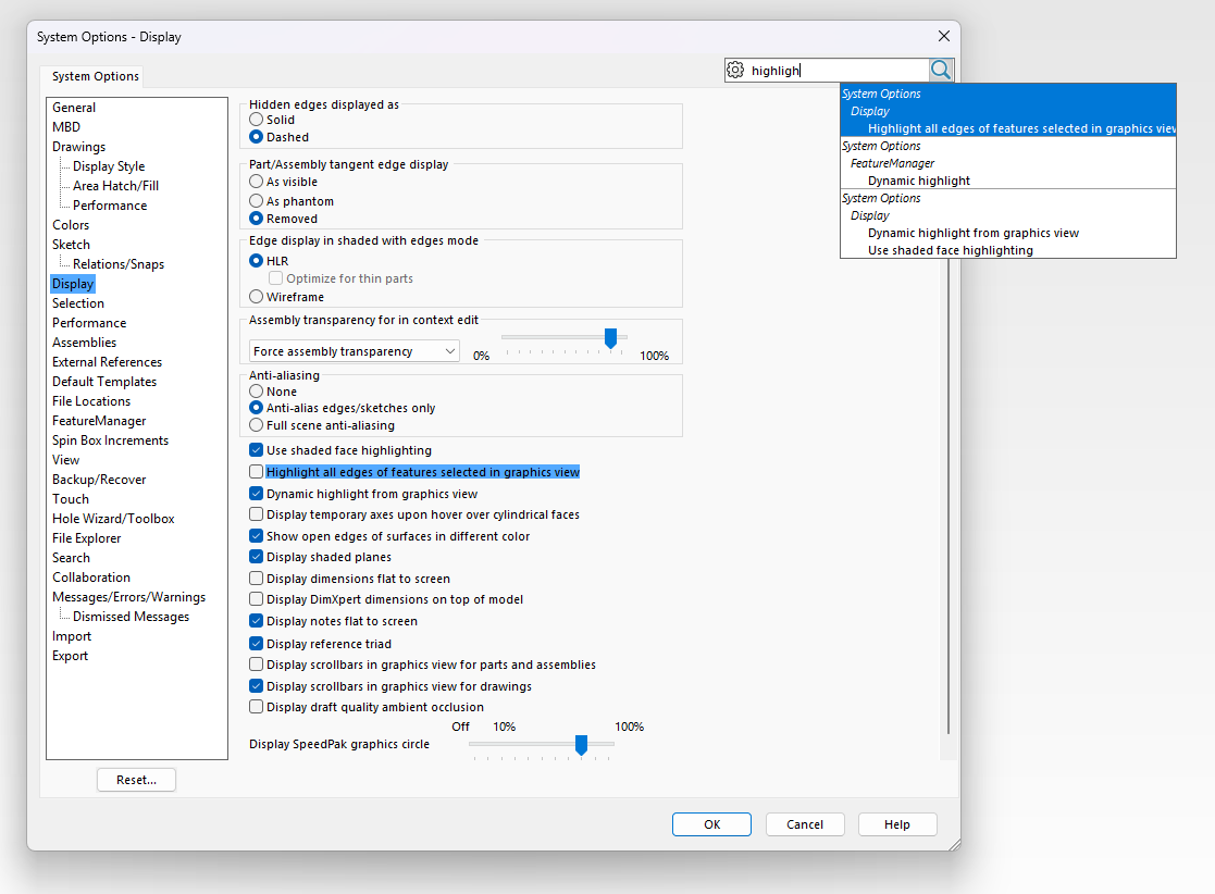

Is this selected?
Bless you.
