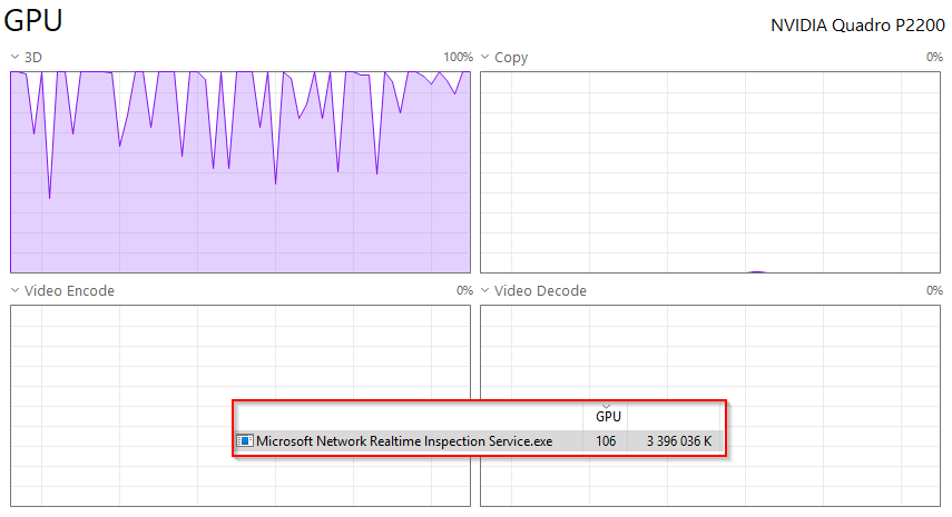

Recently, I noticed my GPU (NVIDIA Quadro P2200) was constantly running at 100% 3D load, even when no graphics-intensive applications were open. Task Manager showed high GPU usage with no obvious culprit. Chrome was closed, RealView was off in SolidWorks, and idle processes were minimal.
After digging deeper:
  • I checked the Task Manager > Details tab and found a suspicious process named:
    Microsoft Network Realtime lnspection Service.exe
    Note the subtle deception: “lnspection” with an “L” instead of an “I”.
  • The file was located in:
    C:\ProgramData\CABService\
  • I inspected the digital signature and found it was “signed” by lolMiner, a known cryptocurrency mining tool.
  • It was also listed under Windows Defender exclusions (!), meaning it was deliberately excluded from scanning.
Microsoft Defender didn’t detect it due to the exclusion.
I ran a set of reputable antivirus and anti-malware utilities** to detect and remove the threat.
detected:
  • Trojan:Win32/Kepavll!rfn
  • PowerShell.DownLoader.2535
