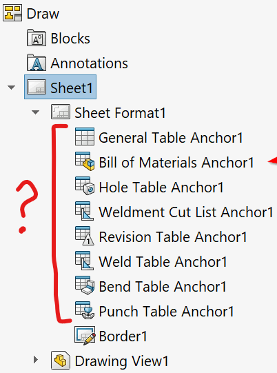

Get Template Anchor Points
I want to insert a block into a drawing so that the block falls into one of the anchor points for the tables.
For example, to the anchor point for “Holes table anchor1”. How can I get these pre-arranged points on a drawing template?
