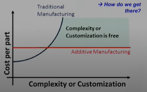

Not sure if Generative Design is very useful for conventional manufacturing, since removing material and adding complex curves increases the processing time; but for Additive Manufacturing it will truly shine, because in AM customization is pretty much free. It is more about getting the initial cost lower to become more popular.
