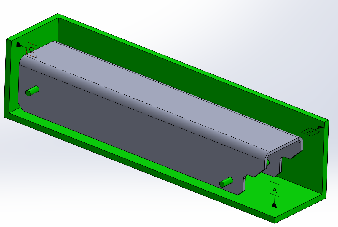

This is what’s in the shop now:
I don’t think it relay the intent completely.
I think your drawing is getting worse, but it sounds like you are doing what your are told.
A jig like this would verify alignment and hole minimum size and represent probably less than an hours worth of work. There might be good reasons to not do this.
That drawing was approved by management and QC. I tried but they believe they’re correct.
A jig need to be “certified”. Check on CMM.
Technically not complicated.
5 measurements. One at each end of the flange (2.12). All 4 should be within 0.01. 2.12 ref only.
And 2.000 +0.020 -0.
Frederick_Law The drawing does little to insure the holes are aligned across both flanges. There is a lot of room for tolerance stack up with the dimensions and standard ± tolerancing. I don’t know the design intent so its hard to say for sure, but the holes need to be toleranced relative to each other with a position tolerance, not the edges so much.
This is likely overkill for your equipment’s capabilities, and I just made up some numbers. Ultimately, you have a design requirement and the drawing needs to reflect that. Your manufacturing can either meeting the requirement or not, then you negotiate. UU
My GD&T-fu is rusty…but here goes…
Gage to check based on MattW suggestion.
